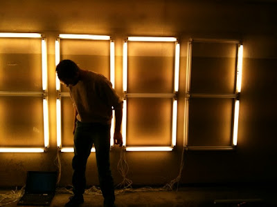

This is actually something made by a pair of artists, where my contribution was the Arduino code and a relay-switch-module to drive the 220V flourescent tubes. The original post is here http://www.arduino.cc/cgi-bin/yabb2/YaBB.pl?num=1273837957
Originally estimated at a few tens of Euros/Dollars, and a brief moment to write the code and a few hours for the electronics it ended up costing about three times as much and more like 100 hours of work. There were unexpected ... problems.

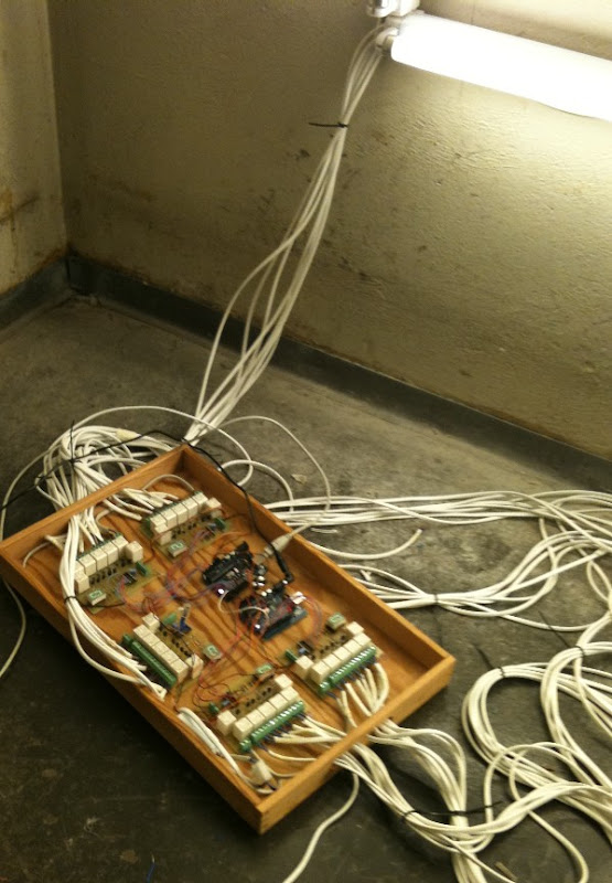

Firstly the very simple&cheap interface circuit of one optoisolated triac driven directly by the Arduino and going directy to the tubes had to be changed for a Arduino to BCD-7Seg chip to transistors to relays. One circuit board became 5, and then the design was unstable and was replaced by a makeshift workaround using two Arduinos (one master, one slave) controlling two 7seg digits each (pincount limit). Why? Don't ask, it's too much typing for me  :-/
The end product looks like this:
Still, it works, and only needs to last a month or two (depending on how often the exhibit is shown). The code was enhanced from a simple i++; delay(13minutes); to something that did its own integer->7Seg conversion, the same code runs in both master&slave and determines where it runs, and communication uses one single TX/RX line. Two push switches enable setting the counter to an arbitrary value.
Here is the display with a person in front, for showing the size (the display is very bright, but the iPhone camera adjusted this down a lot)
The exhibition venue has a link http://www.etikettmalmo.se/, but it ends soon (late November 2010)
When the exhibition is finished, I'll fix the problem so one Arduino can drive all 5 boards (each board latching it's digit's value).

Why didn't you just use a mega instead? It should have plenty of digital pins to control all the relays :)

Yes, indeed, but the available Arduinos were two Extreeme models.
Senso
Some shift registers(like the 595) would solve that and work easilly with the shiftOut() arduino function, so, is it a clock?

I used a latched BCD-7Seg chip on each board so one Extreeme could drive more than the required 5 digits, but the chip/board failed to work reliably without a major rework (effectivly start from scratch) even though on paper it was a good and correct solution. I've thought of shift regs or ather latch logic, too, but choose the BCD-7seg to keep it "simple and obvious" in design. It's not really a clock, even though it counts regulary
