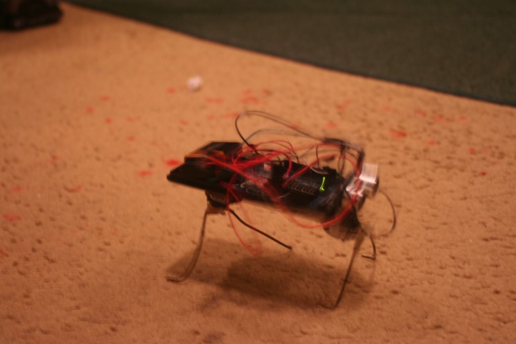

Sorry I have taken my sweet time returning to this forum, life has been busy.
All I've done at this stage is make a to the change to the movements. Now instead of making the foot move from point A to point B, it moves in a path between point A to point B, stopping at a predetermined (set at three in this example) number of points along the path. I have done this in an attempt to create a more accurate path. The path is made from the original coordinates and mathematically added within the program.
There are still a few glitches in it and it looks quite dumb imo, but its a start.
http://www.youtube.com/watch?v=i7LSH_QzORE

Cello62
#17
Feb 14, 2012, 09:04 am Last Edit: Feb 14, 2012, 03:12 pm by Cello62 Reason: 1
Hi
Nice project!
Would you mind to do a litte "instructables" with any photo, to explain how to assembly the legs,wires and sensor?
Thanks for all
