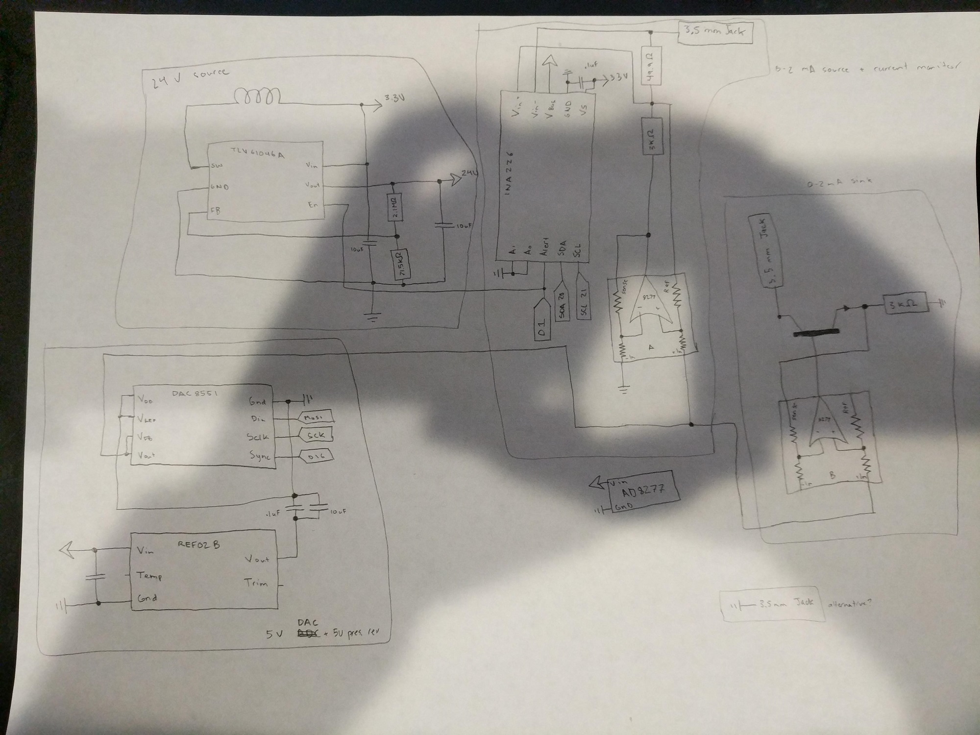

Not sure if this is the best way or place to ask this, but I'm kind of paranoid I've made mistakes and just can't see them because I've no idea what I'm doing. I'm also not sure what the best way to share schematics is, but I've uploaded an image of the schematic.
Essentially, I wanted to make a source for 0-2mAmps, and hook it up to something to monitor exactly how much current it was producing and a display to select exactly what the output should be. While I'm certain there are much easier ways of accomplishing this, honestly I don't much care so long as it actually works.
Given I approached this with absolutely no idea what I was doing, and mostly designed it by just reading the datasheet of the parts that sort of seemed like they'd work, I'm not sure that any of it will work. I'm reasonably confident in subsections like the part producing 24v, given TI provides simulations to show it's results, but I'm less confident I haven't done something incredibly stupid trying to tie together these mostly prepackaged solutions.

INA266 doesn't exist.
Seems you mean the INA226. That circuit is opaque as you've not drawn the symbols for the circuit components - far better to sketch the topology by hand of the crucial parts and take a photo. Use opamp, DAC and ADC symbols, not just rectangles, and make explicit the differential amp internals.
On an initial analysis you've nothing to define Vbus so it'll wander off to the rails and saturate I think. The transistor is all wrong. Feedback from the emitter, not the collector, it needs to just be an emitter follower in the loop.
If you have a current source using a sense resistor you just need to monitor the voltage across the same sense resistor, I think you've over-complicated this.

Is the transistor wrong for a current sink? Pretty sure it's stupid and pointless, but I put a source and sink in it so that both would try to limit their ability to source or sink if I manage to cock something else up. The source is just straight out of the amp, as it's within it's specs. Both are set of off the same input, so they wouldn't be fighting each other, as best I understand it. If it's wrong for a sink I'll try to read more on the subject until I understand what I did wrong though.
I'm over complicating the voltage sensing because I'm trying to measure small amounts of current at high voltage, so I couldn't be sure I knew how to get real accuracy while still protecting the arduino from the voltage.

This is the data sheet for the AD8276 / AD8277 it's just a unity gain IA (Instrumentation Amplifier). Voltage in and voltage out. Looking at the linked data sheet take a look at page 17 figure 50. Not that transistor, a common little 2N3904 PNP is where the current happens. Right up to that point it's all about voltage. Pin 6 of the IA is driving the base of that transistor in its linear region. The values of R1 & R2 are critical and should be matched. That known the data sheet points out:
IO = 2.5V(1/40kΩ + 1/R1)
R1 = R2
That little formula is where we determine what Iout will be with respect to Vin. Everything right up to the base of that transistor is about voltage. All you need is a single DAC to drive the IA and the IA driving a transistor. Matter of fact since you only want 0 to 2 mA you likely don't need a transistor as long as your IA can source that much current into a load.You aren't looking at any current to speak of.
So your DAC needs a stable reference, your DAC drives an IA and that's about all there is to it.
Ron
AD8277 is an opamp with resistors, not an instrumentation amplifier - it doesn't have the 3-opamp configuration of a standard instrumentation amp, its designed to save you needing external precision resistors for a differential amp in high precision circuits.
To draw a meaningful circuit diagram using it you have to make the internal structure of the device explicit.
To provide 2mA there's no need for an external transistor, if you do use an external transistor it needs to be in emitter-follower configuration inside the feedback loop.

Sorry about it taking me so long to follow up on this, I got into the world's stupidest car accident just after posting and was distracted trying to deal with that. Hand drawn attempt at schematic.
So I'd seen this, so I'm not sure why I'd gotten so much of the current source wrong; I think I had it right in the KiCad file, so I'm not sure how transcribing it to Eagle went to very wrong. I think it's fixed now.
Given having a current sink in line with a source does nothing if they're set to the same current, as far as I know, I think I should probably just accept the second op amp in the AD8277 not being used and not needlessly complicate things. I'll remove the current sink and just connect the second jack to ground.
Is there anything obviously wrong with the design after those changes?
