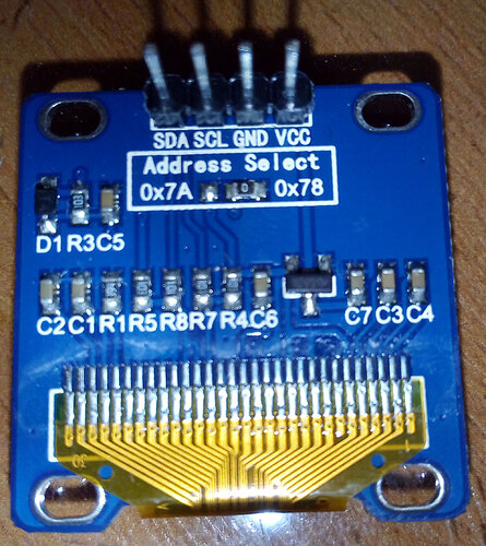

Post a clear picture of the back of the display. There may be some I2C pull ups missing?
Does it work OK if you press and hold the Arduino reset button, then disconnect the display GND line, reconnect the GND line and then release the Arduino reset? (This forces a reset of the display)
back side

yes same results with reset as you advised.
Also tried with U8 library same results.
Should I declare my display faulty ?

The bottom right corner of the glass appears chipped off.
I have bought two such displays that arrived loose in a plastic bag (not even a padded bag). The first looked ok at a glance. On testing with both the Adafruit library set to 128x64, and the text only SSD1306AsciiWire.h library, only the bottom half of the display worked and the default font size was illegible (x2 was OK). Then I noticed both the bottom corners of the glass were chipped, with further cracks to the glass under the plastic ribbon wire. Then I saw this thread and wondered if the illegibility of small fonts wasn't a limitation of the display, but every other line being faulty on the bottom half of the display too. Fortunately the application (a GSM datalogger) this display is largely for debugging and the faulty unit is good enough.
I bought a second unit to see the displays full potential; this arrived similarly poorly packaged and cracked, and didn't work at all (apart from being detected on the I2C bus by an address scanner).
Third time lucky: one seller was listing the device showing it packed in a hard plastic case, this arrived undamaged and the display functions perfectly (the smallest fonts are legible, and the whole display area works) with no changes to the code, confirming my previous problems were down to the cracked glass.

Check this thread on github for another cause of this error:
Someone there mentioned that if the display has a cracked corner, that can also cause this. This was the case for me.
