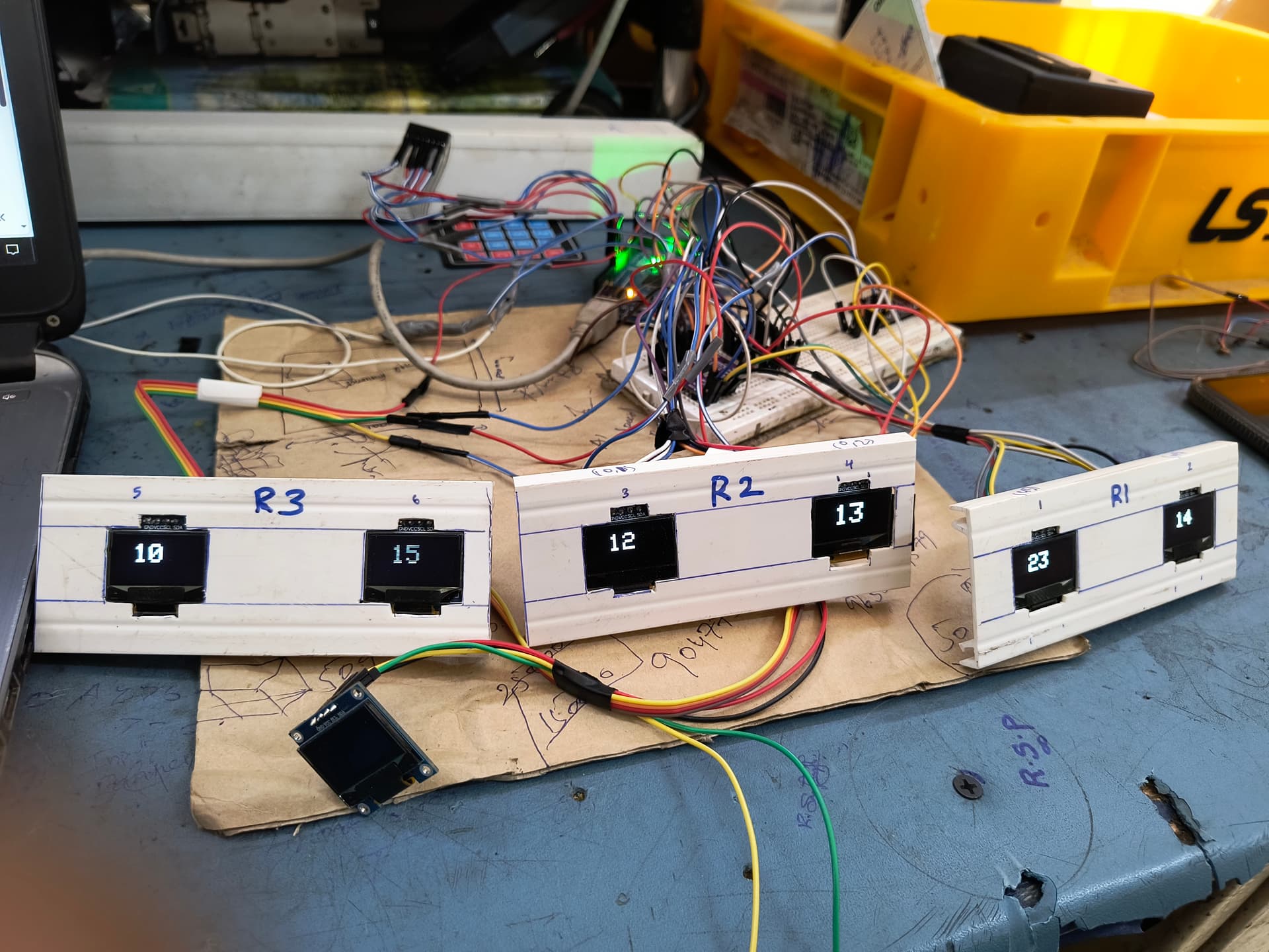

0.96 OLED DISplay with LOOP Issue,,,Need your HELP
I have one Project with OLED and Keypad.If I Press any Number in Keypad it show Correspondin
7displayprob.ino (9.2 KB)
g Value to the all 6 OLED Screen.It s All fine till 5 th Display.
6 th only Continuous Showing All Correspond Value assign With Keypad.\
in previous i Assigned Predefine Value for EachUse code tags to format code for the forum

In loop(), each time you call the printText() function, afterwards you have a call to display.display(), which sends each of the display buffers to the 6th display (because that display is the one selected through the I2C multiplexer at the end of the printText() function).
Thanks a lot..... after Correct it remove all
display5.display();
PrintText()
function it ok....
now Loop function corrected .but when i connect the 7th Display it showing Allocation Failed Alarm.Could you solve this with your Valuable Reply......
What type of arduino are you using? Each display needs 1024 bytes of ram for the display buffer. The Adafruit library will give you an "allocation failed" warning when there is not enough memory for the buffer.
It is possible to use a single buffer with multiple displays, but that does have some limitations.
How many displays are you intending to use?
Thanks for your Reply.......
Now I am Currently Using Arudino Mega 2560 Board..
And also I want Connect more than 20 Display.
if any other method to use all this Display ???..
Create an IIC bus.
You can share a single buffer between all the displays. This has the advantage of needing much less ram, but the disadvantage that you have to clear the buffer between displays.
< edit > Sketch has been edited, I neglected to call Wire.begin() at the beginning of setup()
Something like this:

    Wire.beginTransmission(TCA_ADDRESSES[i]);
    if (i == tca) {
      // set output channel for selected TCA
      Wire.write(1 << channel);
      // for others, turn off all channels
      Wire.write(0);
    Wire.endTransmission();
  Wire.begin(); // <<<<<< edited sketch to add this line
  while (!Serial);
  Serial.println(F("Multiple TCA9548A Example."));
  Serial.print(F("Total number of TCA's = "));
  Serial.println(TCA_COUNT);
  for (uint8_t i = 0; i < TCA_COUNT; i++) {
    Serial.print(i);
    Serial.print(" : 0x");
    Serial.println(TCA_ADDRESSES[i], 16);
  // Init OLED displays
  for (uint8_t i = 0; i < displayCount; i++) {
    tcaselect(0, i);
    if (!display.begin(SSD1306_SWITCHCAPVCC, 0x3C)) {
      Serial.println(F("SSD1306 allocation failed"));
      for (;;) ;
    tcaselect(0, i);
    display.clearDisplay();
    display.setTextSize(8);
    display.setTextColor(WHITE);
    display.setCursor(28, 8);
    // Display static text
    //display.println(F("vj"));
    display.print(val[i]);
    Serial.println(val[i]);
    display.display();
