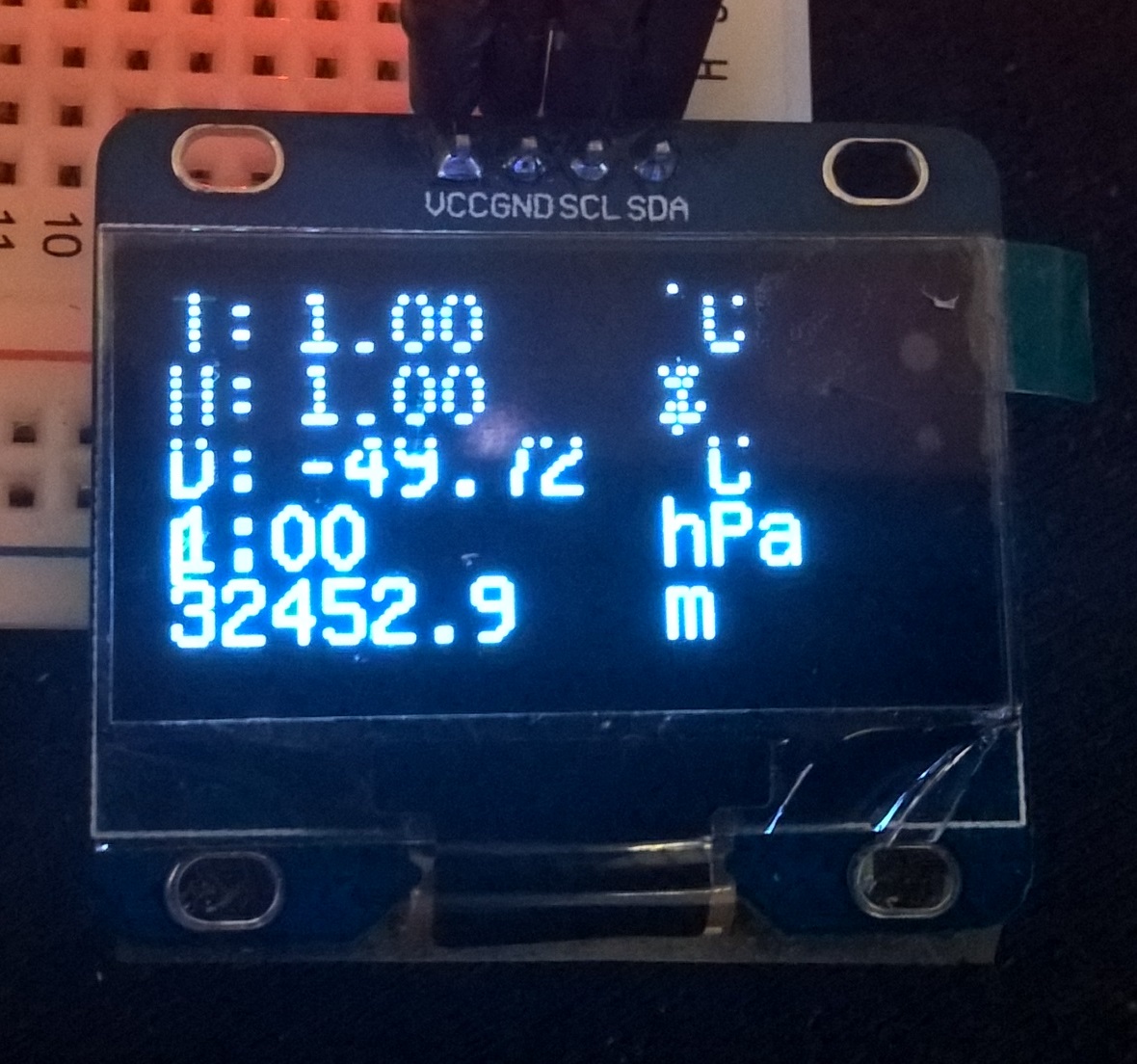

1.3" 128x64 I2C OLED pixel shifted?
Display should be like:
T: 1.00 °C
H: 1.00 %
D: -49.72 °C
p: 1.00 hPa
h: 32452.9 m
But instead its weird shifted at the top but not at the bottom. Please take a look at the picture.
Its connected via HW I2C to a teensy 3.2 with pullups.
What am I doing wrong?
Here is my Display code:
#include <U8g2lib.h>
U8G2_SH1106_128X64_NONAME_F_HW_I2C u8g2(U8G2_R0, /* clock=*/ SCL, /* data=*/ SDA, /* reset=*/ U8X8_PIN_NONE);
Setup:
  u8g2_SetI2CAddress(u8g2.getU8g2(), 0x3C * 2);
  u8g2.begin();
  u8g2.enableUTF8Print();
Loop:
    u8g2.firstPage();
    do {
      u8g2.setFont(u8g2_font_unifont_t_latin);
      u8g2.setFontPosTop();
      u8g2.drawStr(0, 0, "T:");   u8g2.setCursor(20, 0);    u8g2.print(temp, 2);   u8g2.setCursor(80, 0);   u8g2.print("\260C");
      u8g2.drawStr(0, 12, "H:");  u8g2.setCursor(20, 12);   u8g2.print(hum, 2);    u8g2.setCursor(80, 12);  u8g2.print("%");
      u8g2.drawStr(0, 24, "D:");  u8g2.setCursor(20, 24);   u8g2.print(dew, 2);    u8g2.setCursor(80, 24);  u8g2.print("\260C");
      u8g2.drawStr(0, 36, "p:");  u8g2.setCursor(0, 36);    u8g2.print(press, 2);  u8g2.setCursor(80, 36);  u8g2.print("hPa");
      u8g2.drawStr(0, 48, "h:");  u8g2.setCursor(0, 48);    u8g2.print(alt, 1);    u8g2.setCursor(80, 48);  u8g2.print("m");
      u8g2.sendBuffer();          // transfer internal memory to the display
    } while ( u8g2.nextPage() );
"u8g2.sendBuffer(); " is not required. This will be done automatically by the nextPage procedure.
Oliver
