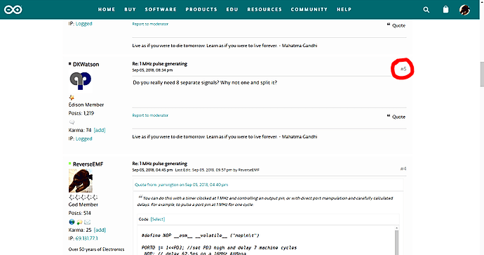

DKWatson:
See #4.
Do you mean #5?:
DKWatson:
Do you really need 8 separate signals? Why not one and split it?
Weird, huh? The numbers change. I think it has to do with whether you're logged in or not [otherwise not sure what causes this -- but I've seen it before] :wink:
