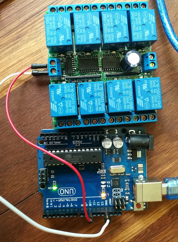

Hi all
I've just got a 1-wire 8-relay switch and I'm just testing it out but I'm not getting any luck. The example I'm using code from Paul Stoffregen as base for my testing. I just want to switch on/off a relay but I'm not even getting connected to the device.
OneWire net(10);
byte addr[8];
BUT
net.search(addr) // returns false
I've got my UNO Pin #10 and GND connected to the 1-wire relay board.
I have not connected the 12V power supply as the guide said it is not needed.
Any ideas why the device won't pick-up?
Here's the setup:
The OneWire bus requires a pull-up resistor. Does the circuit have one?
Do you have a ground wire between the Arduino and the OneWire device? It's called "OneWire" but it requires a common ground.

@Johnwasser
I'm not using a pull-up. That might be it. Let me go see.
@gfvalvo
Thanks for the formatting advice.I was wondering why the image upload only gave me a URL option. Hence the use of dropbox as it wasn't obvious how to manage images. Anyway here's the image.
I'm using a 1-wire Wirecom8 relay control board (sorry, no product serial is on the board)

OK, here's the image as I requested it be posted in-line:
Now please re-post the code using Code Tags as requested.
And, how about links to the relay board and 1-wire device?
I also wouldn't attempt to use parasite power mode for the 1-wire bus until you get the hardware and firmware working.
