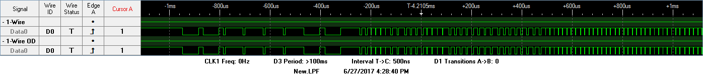

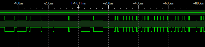

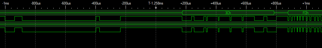

Right sorry, poor choice of words on my part. I do have a logic analyzer and while I'm seeing similar pulses the emulated chip isn't matching up to the real one.
(I've attached what I'm seeing to this post)

As far as I understood it they tested with two masters. Is your's one of the two types that they tested with?
The pictures you posted both show only 1s, the emulated signal looks exactly the same as the EEPROM signal. Are you sure your master is working correctly?
No its a different master than those two but it's working correctly as a master. I've been able to have it correctly read 3 different (real) DS2431 chips that I wrote unique values to just fine.
So what are the pictures showing then? Do you have pictures where not just 1s are sent?
"EEPROM signal" is the real chip signals that the Logicport sees as its being read.
"emulated signal" is the same view but with the emulated chip.
Any values that I have on the chip look the same when being read so I'm not sure what other kind of pictures you'd like to see.
I would like to see a picture where some '0's are sent, that means that the data line has to be pulled low for at least 60µs, all shorter pulses are '1's.
As both the "original" signal as well as the emulated look exactly the same I can just guess that you measured the wrong period of the signal.

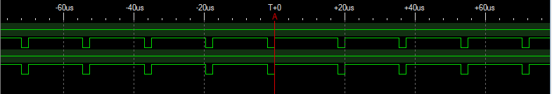

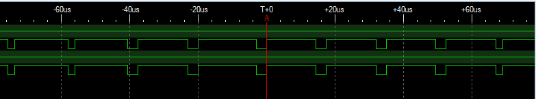

Hmm maybe these will be more useful then. It's a capture of each signal as they begin before they all turn to ones. Albeit it seems like the real chip is only ones....
Images embedded for our convenience. Technique described here.

When you are comparing traces, it would be nice if you use the same time scales.
Why two identical traces? This is a 1-wire protocol, after all.
And keep the image width below 600 or so. As you can see, the wide images get scaled by the forum to the point of unreadability. It's "inconvenient" to download a file, then view it...
Right sorry, here's some better captures. I'm still trying to get the most useful looking parts in a single image so let me know if you still want more.
Emulated.
Actual chip.
What's the signal of the real chip before the part that is visible now? Because that part in the emulated picture conform to the 1-wire protocol as the standard defines it. The rest seems to be a much faster version. If the real chip has the first part identically too, that part seems to switch to the faster protocol (perhaps for backward compatibility.

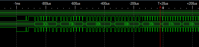

Yes I forgot to mention in each picture the bottom signal is overdrive. Here's a clearer example of what's going on with the physical chip (Which is full of 0's).

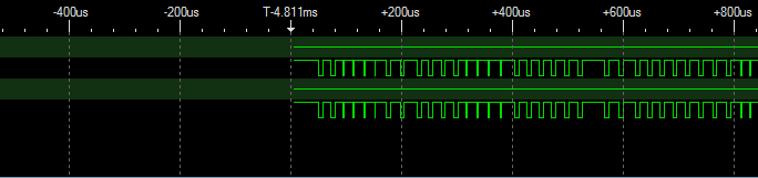

Here's also a better look of what's going on in the emulated signal. Seems like its not working in overdrive even though the emulator ought to support it? (Sorry its rather too large to embed)
Did you activate the overdrive functionality in the library? By default it is deactivated. OVERDRIVE_ENABLE in OneWireHub_config.h.
Oddly enough I had changed that value but it seemed like I was getting the same results shown in my previous posts. I went ahead and deleted the library, re-downloaded and changed the value again. Now the line appears to be switching back and forth from overdrive (seemingly more often than the chip). When its in OD I'm seeing 3Ch (Overdrive command) followed by F0h (Search ROM command) much like the actual chip. However after two 00h's the line goes back to FFh...
The DS2431 emulation that is delivered with the OneWireHub library doesn't support all features of the original chip. The Overdrive-Skip ROM command is not supported. If your master needs that special features you have to write your own version with all commands supported.
It also seems that your master doesn't enter the overdrive mode the usual way (reset shorter than 80µs) but that's only a guess from the logic analyzer pictures you posted.
I would record a complete access loop of that master with the logic analyzer, write down all features of the DS2431 that are used by that mystery master and then write an emulation of the chip that supports at least these features.

What I'm still don't understand: In the emulated picture we see almost one byte in standard speed (I guess it's 0x3C too), but in the chip version we see only overdrive speed. Is that because you didn't scanned at the same part of the communication or does the real chip really not have any standard speed communication? Have recorded once the original reset command?
