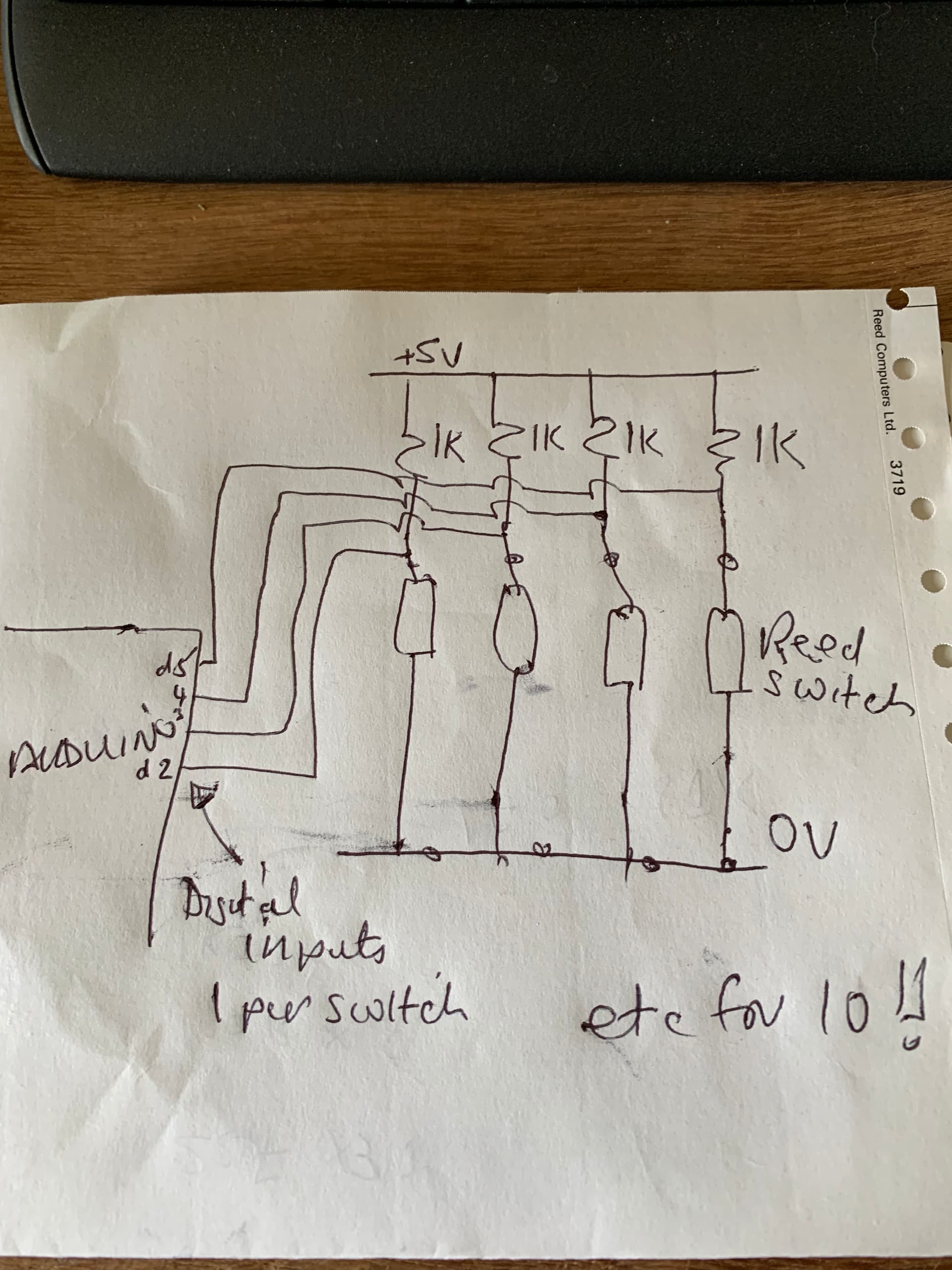

I particularly would not use two wires per reed, I would use one as common GND for all and one return for reed, only 11 wires. And as already indicated @Railroader configure the pins in PULLUP with their internal resistors.
The electrical scheme is simple:
And some basic code for testing:
That's no good. The pullups must be near the receiving end to work the best. Read switches usually have not "pullups". Pulled up to what?
That is a mistake. Use a least twisted pair cables between the switches and the controller. That will be much more resistant to electrical noise. A spider network of grounds and lonely signal cables is not advisable.

As @gonpezzi correctly said, I've all the wires and reed sensors already in place, with no intention/chance to change anything in the existing setup.
The infrastructure is designed to be compliant with a VdS certified alarm system (a standard i.e. here in Switzerland). The sensors even have 4 wires each (2 wires for open/close, 2 wires for sabotage detection). Instead of relying on a commercial system, I just want to read the reed sensors myself, but only the open/close states, the sabotage contacts do not matter for now.
@Paul_B thanks for the hint with placing the resistor on the 5V lane. But, I don't get why the resistors should not be placed close to the sensors. My priority is to protect the sensors against unwanted side effects of other wires/cables in the near - not the Arduino that can be replaced easily.

That's how I just implemented the design, based on the suggestions so far - with a quick live test.
Except one thing: @Paul_B you've suggested to put the resistor on the 5V lane instead of on the ground lane. There are some threads, where others say it should go on the ground, to have a solid "low state". That is the only thing that I would like to sort, before doing further live tests.
After that has been sorted, I'll move the resistor as close to the reed sensor as possible, as "standexelectronics.com" has stated.

I’m not sure if the multiple sensors bit was understood , but with my organic graphs tablet ….This is how I would basically do it
There can be issues with long cables though and I would probably go with opto isolators and/or bit of filtering -but worry about that if it happens .
If it’s an alarm system you might want a “tamper loop “ too.
