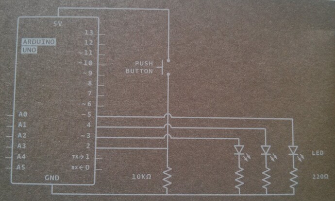

10k-ohm resistor between switch and ground: why?
Hi all.
First of all I want to specify that I'm a total newbie to arduino and in electronics in general.
I'm approaching to Arduino and I bought "The Arduino Starter Kit" from the Arduino Store (the board is Arduino UNO).
I just completed "Project 02" but there is a thing about the electronic schema that I don't understand (maybe a little early to have dubts? :slight_smile: ).
The project is very simple (attached an image of the electrical schema): basically there are 3 LEDs connected to 3 pins (output mode) of Arduino and a switch connected to another pin (input mode). The result is the switch controls the powering on/off of LEDs.
As you can see in the schema, there is a 10K-ohm resistor placed between the switch and the groud: why this?
About this, the instructions says "You'll also need to add a 10k-ohm resistor from ground to the switch pin that connects to the Arduino. That pull-down resistor connects the pin to the ground when the switch is open, so it reads LOW when there is no voltage coming in through the switch".
Sorry, but I still don't understand. I mean, when the switch is up, the circuit is not closed, so the electricity doesn't pass through: so which is the function of the 20k-ohm function?
So, I said: "let's try to replace the resistor with a wire and see what happens", but when I press the switch it seems that Arduino powers off and reboot.. something about crashes and reboots to avoid damage...
Can you please help me to understand this?
I repeat, I'm totally dummie about electronics, please be patient.. :slight_smile:
Thank you very much.
Have a nice day
Luca
The switch connects the pin to +5V so it needs a pull-down resistor. An unconnected
pin (think about the switch being open and no resistor present) will float (its voltage
will vary at random due to capacitive pickup from the surroundings - a pin in input
mode carries no current (to a good approximation) so picks up any nearby influence.
The standard way to connect a push button is between the pin and ground, allowing
the built-in pull-up resistors to be used (pinMode (pin, INPUT_PULLUP))
lucapolitti:
So that the input to the pin is connected to something - it's in a known state. If you don't connect it to anything it can give random values (it picks up radio waves, etc.)
lucapolitti:
Of course it will, you just connected 5V to GND with your switch.

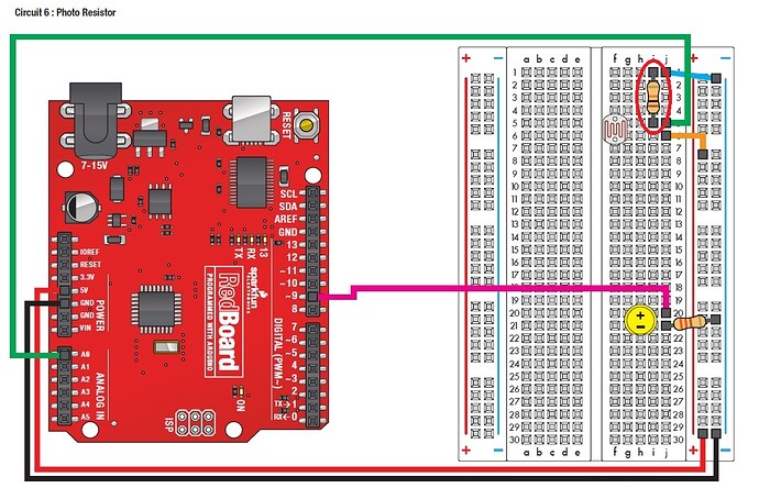

Hi. I was reading your post and I have a question about the placement of a resistor in the RedBoard guide. I'm also new to electronics so pardon me.
The following circuit uses a photo resistor to control the brightness of an LED. I was wondering why the resistor(circled in red) is placed after the photo resistor, instead of before. If the resistance of the photo resistor were to drop to a very low value (close to 0), would there be a short-circuit because the 5V pin would be directly connected to A0? Or is there like a minimum resistance for a photo resistor?
Hope to be enlightened by your knowledge. Thank you.
no, ther would not be a short-circuit here. The wiring is 5v-LDR-resistor-GND , and A0 connected to the LDR<->resistor junction .
if you put the resistor between 5V and LDR, it will work, but you'll get t a reverse information :
wired as it is, if the light is brighter, the LDR resistor is lower, and the value on A0 increases .
If you put the resistor between 5V and the LDR, when the light is brighter, the LDR resistor is lower, and the value on A0 decreases.
