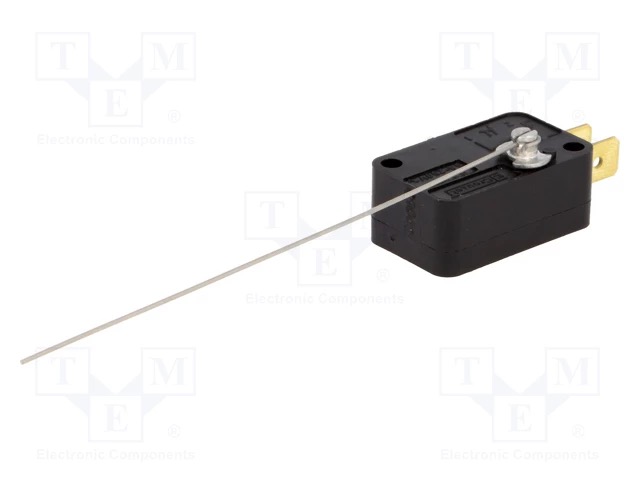

Lets call them by their well know name of "micro switch". Do you need the SPDT type switch that you show? Do you need the lever, AKA leaf type actuator, or will a switch with a small plastic protrusion work for you?

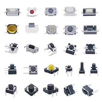

Is it possible to use a microswitch spaced away from the narrow gap? Maybe use this style of actuator:
Image 6
Any method of registering contact between cube and switch is fine. I will now be calling them "micro switch", thank you for the correction.
This, with a mechanical interface/linkage would be the obvious way to go IMO.

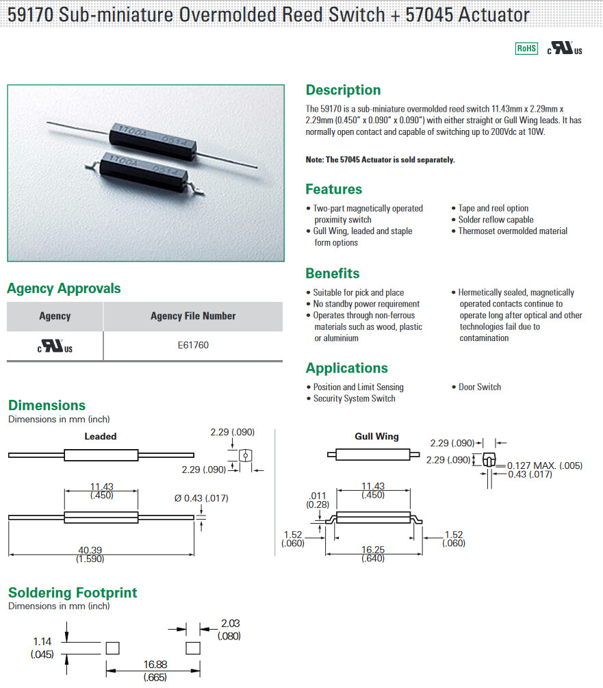

Can you glue a small magnet on the moving part, so that you could use a tiny reed switch?
This is just a 2.5 x2.5 x 16mm example
Then two metal dots on the back wall with wire leads attached and a piece of metal on the moving piece will be very thin and will act as your switch when they are in contact, the moving part is acting as the switch.
Yes, that would be possible, thank you for your suggestion!
I will mark the reed switch answer as "solution" for now.
