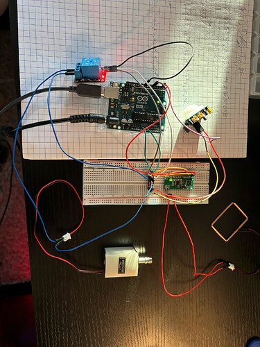

I'm currently trying to follow and RFID cat door project by @EdgeSam
> [@Combined 2 sketchs cat door SUCCESS!](https://forum.arduino.cc/t/combined-2-sketchs-cat-door-success/638093):
> Hello, I'm an extreme newbie. Been attempting to build electronic cat door. Purpose is to let our cat (Shadow) in and out of garage and not @#%$! racoons. The mechanics of the project is easy for me but the Arduino code is not. Been researching for weeks, my mind can grasp the basic programming but not the specific programming needed to make this work. Desired scenario as follows. Shadow approaches from outside wearing rfid tag, Door unlocks, Shadow enters, Door locks 20 seconds later. Shadow…
I've got the new code involving millis() he updated, but I can't figure out how he could've done his wiring. I'm a major arduino/circuit newbie, but need this project done within the week. I'm using the same PIR sensor, Arduino Uno R3, and an alternative 125khz RF reader identical to the Seeed one, but just can't figure out if its my wiring that needs to be fixed or if I need a different solenoid. He's using an XHQ-PT solenoid, but those go for like $25+ on amazon. They're also limitted in being stuck open or stuck closed and I can't figure out which one is which. I'm using a basic dc12v push-pull solenoid, but it will either be stuck open or be stuck closed depending on whether I connect it to NC or NO and the RF Read and pir sensor don't change that even if the LED changes from high to low and vice versa. If I need to buy the different solenoid I will but I would prefer to have some form of guidance.
Pictures of wiring (very messy)
 ![image0](https://europe1.discourse-cdn.com/arduino/original/4X/2/2/d/22d786a765605ee99d48b26395c4852405e9c40f.jpeg)

The solenoid specified for the project has a 40mm movement. Does your replacement also have a 40mm movement?

The problem I'm having right now is that even though the code seems to be working the solenoid doesn't seem to be receiving any voltage. No matter what I do the solenoid doesn't retract. I can see the LED changing from high to low and vice versa on the relay, but the solenoid won't retract.

So, you are not testing the door by using the solenoid directly connected to the power?

I will head to walmart and grab some, but right now I noticed that the relay is receiving power, but the common contact point voltage doesn't change when the LED input changes. The NO and NC work properly, but I can't tell if there is a problem with the center contact point. I'm basing it off of this image.

> [@mystllk](#):
Sorry, but that statement is totally illogical! The common contact is connected to the NO screw when the relay is not energized, but is connected to the NC screw when the relay is energized.

So then do I just run one wire from the common contact point to the solenoid instead of the messed up wiring I’ve got going on? I’ll check when I get home, currently looking for alligator clips.

So idk what I’m doing wrong to be honest. The only time the NC screw is powered is when the common contact is connected to the power from the arduino. I tried taking a video, but the format isn’t permitted on the forums. Essentially the way I have it hooked up is the relay is powered and grounded to the arduino through the breadboard. The input is connected to slot 9 on the arduino. I have the common contact point hooked up to the 5v from the arduino on the breadboard and I have the solenoid grounded to the arduino with the solenoid’s power hooked up to the NO on the relay. I can tell I’m doing something wrong, but I’m entirely lost. My knowledge on the channel relay is based on this link.
> **[In-Depth: Interface One Channel Relay Module with Arduino](https://lastminuteengineers.com/one-channel-relay-module-arduino-tutorial/)**
> Learn to interface one channel relay module with Arduino along with relay working, hardware overview, pinout, wiring and arduino code.

> [@mystllk](#):
No.
You have to connect the common connector to some sort of power, and then the NC will get this power if the relay is **NOT** activated.
You seem not to know how relays work. Try searching the net for a nice video telling you how they work.

Ok, that’s what I thought. I’m looking at EdgeSam’s Millis code and he says that he hooked up the channel relay to pin 9, but then in the code writes pin 9 as a status LED instead of the led for the channel relay which seems to switched to pin 13. Now I’m confused on whether I need status led’s and why the channel relay isn’t receiving any output from the pins inside the void loop.

I think I see my problem. I have my ac power connected to my arduino. I’m actively using that same power as the power to power the relay and as the AC power for the solenoid. From what I’m seeing the solenoid needs to be connected to a separate source of power.
I’m currently trying to power everything through the arduino connected to a solderless breadboard. The arduino is powered by an ac adapter and my laptop. I have 2 jumper cables running from the 5v and ground to random spots on the breadboard and I’m connecting everything else to the rows connected to this 5v and ground jumper cables.

I just don’t know where to go from here. I don’t know if I need to go a get a seperate power source like a battery to power the relay while the COM receives power from the arduino or if I need to reroute my wiring so that the AC adapter powers the solenoid while the rest of the circuit receives power through a battery.
