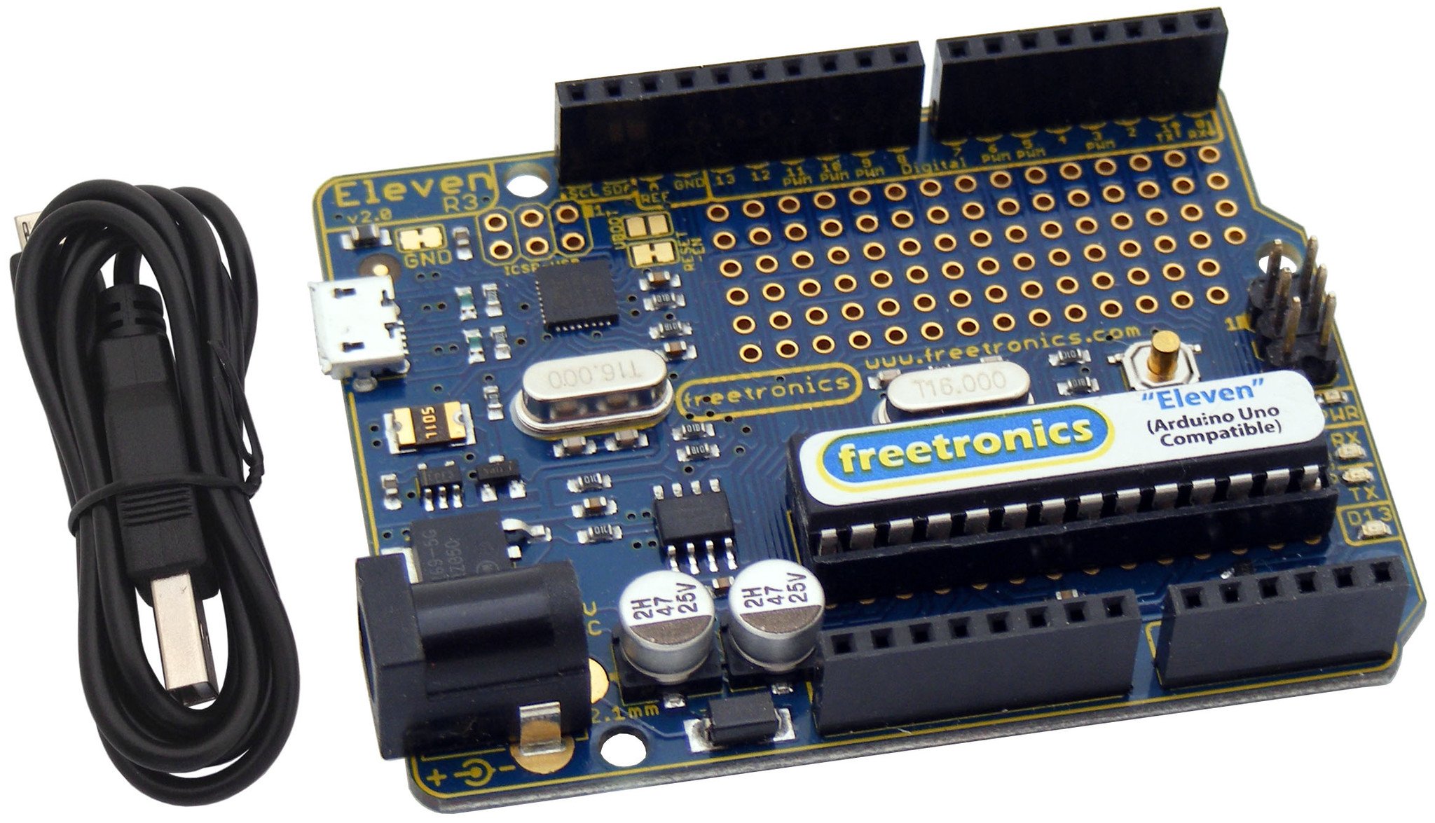

I recently acquired an arduino uno clone board, and 128*64 LCD display constructed by duinotech.

and for anyone wondering the cloneboard is a freetronics Eleven board linked below.

You can pick up a second 5V from the 3x2 ICSP header.

Thank you for the quick reply, now the only question then, and I'm sure I should already know this, is how do you draw 5V from the ICSP header? again I know I should probably already know this but thank you for responding
From memory, pin#2 on the ICSP header is 5V. pin #6 is 0V.
Just attach female dupont jumper wires from the 3x2 to your LCD.
In fact you also have MOSI and SCK on the 3x2.
So it is very handy for connecting to a SPI display like your ST7920.
David.
Refer to the schematic file
file:///C:/Users/rexchen/Downloads/ElevenR3%20(1).pdf
the power pin pin2 and pin5 are both the 5V power
BTW, David is correct of ICSP 5V and Gnd pins.
