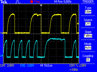

The scope showed reasonable signals (they would have been better with pull-up resistors):

And just to show what the pull-up resistors do, here is what the waveforms look like without them:
And, with 4.7k pull-up resistors:
Notice how the signal is much squarer looking.
Yes, the internal pullups are way too weak for I2C. 4.7K makes a huge difference, or 2.7K/3.3K for pullup to 3.3V.
Especially if one wants to run at 400K.
