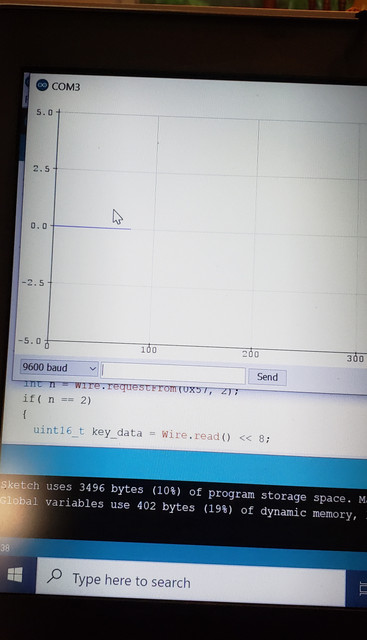

12C scanner, identifies one device but not other three
total newbie here. having no luck getting i2C scanner to show me the address of three (of my four total) i2c devices. i2c scanner does find and give me the address of my 20x4 LCD, but won't give me an i2c address of (any of my three) robotdyn TTP229 16-key capacitive touch modules. instead, in serial monitor, i keep getting the dreaded 'no i2c devices found' dialog. been trying & retrying various things, rebooting etc for about ten days now, but never can get an i2c address for any (of the three) robotdyn modules.
ideas, things tried so far, and questions:
  1. SOFTWARE DEFECT in my =particular= copy of, or version OF 'i2c scanner' code? unlikely - I've tried numerous versions found online, made no diff :-(. but 'board info' gives me serial numbers for each of the three modules, so?
  1. does the i2c device ITSELF need to have a "library" (aka some 'code'), running ON IT in order to be 'seen' =BY= i2c scanner?
    (robotdyn 16-key TTP-229 modules). seems unlikely, but ?
  2. wiring defect? eg: jumper leads installed on a wrong pin, or two? tried swapping SDA & SCL leads, made no diff :frowning:
    doubt I made a wiring error; I've checked it numerous times ...
  3. wiring defect? eg: in one (of the four, brand new, carefully installed) jumper leads? eg: like no continuity? unlikely, see last comment@bottom of #6, below.
  4. wrong VOLTAGE? (robotdyn specs say these are 3.3 to 5.5 volt modules) tried both voltages, made no diff
  5. maybe all three robotdyn modules =themselves= are defective? so try 2nd & 3rd of same module, and/or also try my 2004 LCD, maybe...later TRIED ALL THREE of my TTP229L modules - all three yield the dreaded 'no i2C device found' dialog. HOWEVER, after that, and running same code, jumper leads, etc i2c scanner DOES 'see' my 20X4 LCD, and DOES give me =ITS= i2C address ...
  6. lack of pullup resistors? 4.7Kohm? pair?need to use? if use, one or a pair? I'm totally unclear on this, can't find the word 'pullup' in my code anywhere, so remains unclear if it 'defaults to' =using= the arduinos on-board pullups, or not...
in the tontech TTP229 pdf, top of page 8, pullups are 'mentioned' in last line of paragraph one. but unclear what that means, or what to do/baffled...
this is the entire Tontek TTP229 PDF:
moving on, and leaving all above as described, next tried 'the breadboard & resistors thing', using two 4K7 resistors, which still made NO DIFF, aka 'no i2C devices found'.
again tried two (of the 3 total) robotdyn modules, no luck, no diff, yields same dreaded dialog.
  1. what is the 'default state' of the pullup resistors on the arduino uno board?
    (they're supposedly controllable by software). is/are it/they enabled? disabled? i got no clue ...
  2. bonus question: in the IDE, how do i make the line numbers SHOW in my code?
thanks very much for pointing out thing(s) i missed, did wrong, etc. specifics "in massive detail, suitable for the near brain-dead" much appreciated, guys :slight_smile:

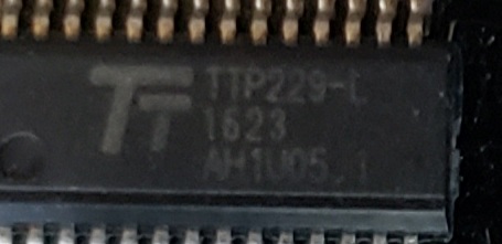

these (problematic) modules are sold as being TTP229 modules, however the only data sheets i can =find= for them reference them as being TTP229-LSF chips, and, to add insult to injury, the numbers =on= the actual chips, near as I can tell, are TTP229-L, and aren't 'really' either of the earlier-mentioned chip numbers here. wether that =matters= to my problem (or to our discussion), again i HAVE NO CLUE.

The text on a chip is often shorted and sometimes almost not recognizable.
There are many counterfeit chips (more than you think), but so far I see no indication that you have counterfeit TTP229 chips.
When you look at a TTP229 module, there are small black smd components with the text "472". They are resistors of a "4", a "7" with "2" zeros. That is "4700" and that is the resistors of 4k7.
In Europe they use a flat horizontal line as ground-symbol and a rectangle box as a resistor and the multiple lines for earth-ground.
In the US they use triangles or multiple lines for ground and those zig-zag things as a resistor.
The question is: are they pullup resistors to VCC or are they pulldown resistors to GND ?
When you heat up such a resistor with a solder blob that heats the whole resistor, then it falls off the board in one second.
You have to consider them as bad modules anyway.

hello Koepel :slight_smile:
tried your new revised code, no clue what i was really supposed to see. i assume it's your revised version of 'i2C scanner', tried it, was sort of expecting some kind of 'address report' saying something like 'i2C device found at address Ox34', or something similar...
pix here are:
  1. overall wiring shot (exact same as 1st time around), and
  1. serial monitor view: saw multiple lines of zero's printed out very quickly, and
  1. opened serial plotter (no clue why, but did anyway :slight_smile: saw horizontal centerline expanding rightward from 0/0 position at medium speed...
but, then again, maybe this is all exactly what I was =supposed= to be seeing <?>. i did count 'zeros per row' and found 16, so might be some 'hidden mystical symbolism' in there <?> also looked at your code, (awesome stuff, admittedly 99% beyond my comprehension) and did find an i2C address IN your code (0x57), so maybe ALL 3 of these modules of mine* bear that same address, and these results just =confirm= that fact <?>
*or, possibly 'worldwide', too, for all i know. i tried 2 of my three today...same result..
well, yeah, i'm clueless, I can only offer 'best guesses'...
thanks again, sir
The test-sketch shows the inputs, all 16 inputs.
0 : not active
1 : active
Try to touch a input pin, or use a metal screwdriver or so for better contact. Use the serial monitor of course, not the serial plotter.
When the TTP229 is not connected, then you will see "TTP229 not found" instead of the 1's and 0's.
The TTP229 initializes itself after power-up and takes in account the metal that is attached to the inputs. Therefor you should not touch an input when turning power on.
The 28-pin TTP229 can only have I2C address 0x57, nothing else. Therefor you can use only one on the I2C bus. Please reread my previous post for solutions to use more TTP229 modules.
