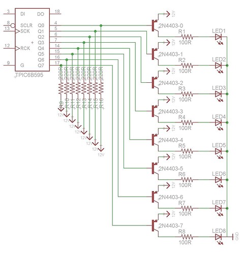

Thanks crossroads, I have now ordered some 2N4403 P type transistors to try. Can I check I have read the diagram right: drain to 12v, source to segment and gate to shifter/ pulled up to 12v via 5k resistor. Thanks, will let you know how I get on.
Okay, thats not a P-channel MOSFET, that is a PNP transistor.
http://www.fairchildsemi.com/ds/2N/2N4403.pdf
Wire it up like figure 1 - connect 12V where it shows ground and the LED string to where it shows -30V.
I went for a non-MOSFET as P type mosfets seem to be about 10x more expensive and rare in a TO92 package (what I have space for) - hoping it will work.
Figure 1 shows a 50R resistor going from gate to GND.... What value should i use and would it go to GND or 12v? Thanks for pointing me in the right direction.
I'm thinking something that the shift register won't have to sink as much current thru.
Try a 1K to 12V and see how it goes. If the LEDs are not turning full off when the Gate is high, then go a little smaller.

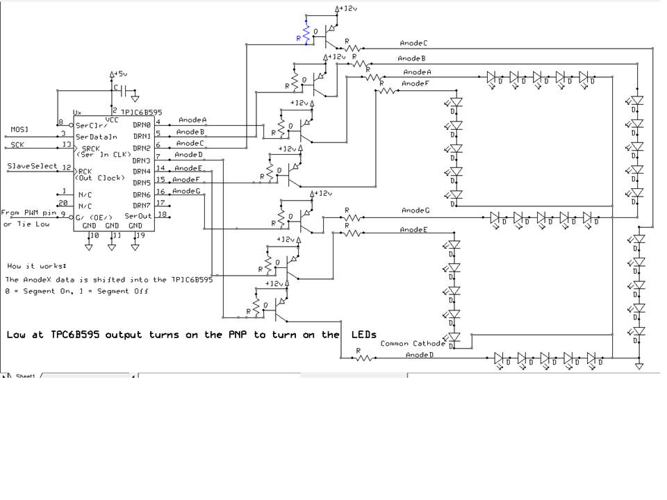

Hi, I have been looking around for a nice solution to driving 3no. large 7 LED segment displays @ 12V and came across this thread: http://www.arduino.cc/cgi-bin/yabb2/YaBB.pl?num=1212882269/15 - the last post in the thread is very neat so happy to have found a good solution I headed out to find some Allegro 6278EAT chips for the project..... only to find they are out of production????? ??? ????????? ????? ?????????? ????????? ????? ????? ????? ????? ??? ????? ?????????? ???????? ???????? automasys.wordpress.com ????? ?????????????? ???????? ???? ????? ?????? AVR ARM LPC STM32 PIC dsPIC 8051 8086 z80 ????? ???????? ? ?????? ??ARM AVR PIC MicroController Electronic Project GPRS GSM USB BlueTooth Ethernet Network CAN I2C SPI RS485 Automation PLC ????? ????????? ??????????? ??? 8051 ???? ?????? ???????? Interface ???????? ?????? ??????? Visual Studio 2010 C# VB.Net Protel DXP Altium Eagle PCB SPICE PSPICE HSPICE ADS OrCAD Silvaco
I'm wondering if anyone can suggest an alterntive chip or an equally nice solution to the problem....

Lower the resistance on the PNP gate pullups - that should turn the current off better.
What are you using now?
Thanks - my first attempt was 1K, just tried 560R which had a similar result - how low can I go before I break something?
A quick update... now reduced the pullups down to 220R... things are improving but not there yet... just not sure if I will cause damage if I go too low?

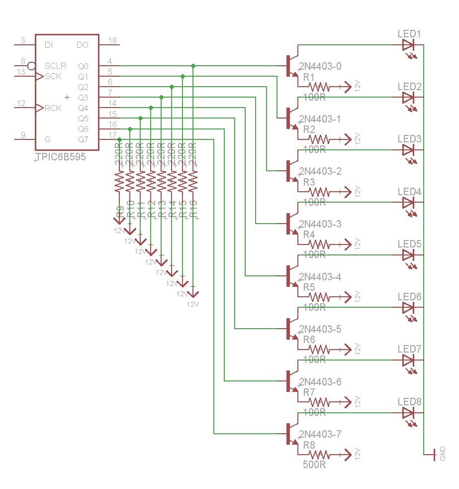

Post your current schematic, lets review.
Okay, that Schematic as drawn will not work.
You need PNP's wired up like this:
http://www.mayothi.com/transistors.html
Now you're looking good!

I have the circuit breadborded out as per the last schematic but with 1K pullup resistors - it all seems to work great with the exception that the shift register IC gets too hot very quickly. Is there anything I can do to solve this?
