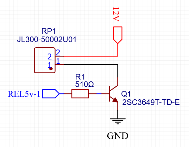

Guys, thanks a lot for the feedbacks. To make it clear, this is the part of the schematics that I'm referring to.
immagine
  • REL5v-1 is my GPO on/off switch controlling the Q1 transistor.
  • RP1 is the connector I want to use to power my external devices.
As said, I need both to control on/off state of this circuit and max current (1amp) when state is on. Consider that my RP1 connected actuators are not known in advance and may go down to request only a fraction of max current...
Thank you dearly to all of you.

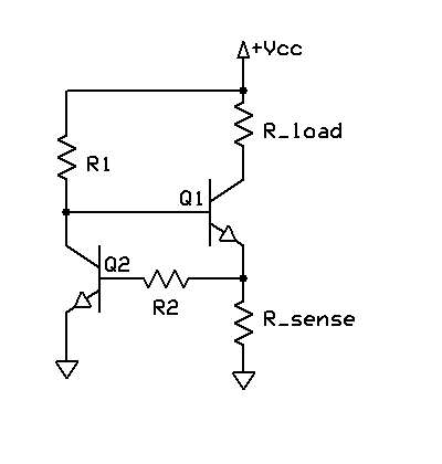

This circuit would be a good solution for you:
R1 is your input, Rload is your relay. Rsense set the current limit (R = 0.6%V / I_limit ). I do not think R2 is really needed. I've designed in millions of these. Simple, low cost and effective.
It sure is but..... Suppose the worst case of a load being 0 Ohm, short circuit. Transistor Q1 will then discipate Vcc * 1 Watt. That calls for a good heatsink.
As already told, when the current limiting goes active the load doesn't get Vcc at all. One method practiced was to give the controller a signal and the controller switched the relay off.

Does the power supply not have current limiting (output protection)?
Of course it does. The point is that I have 4 of these transistors lines acting as relay and each of the present transistors supports 1.5amps. As the psu allows more than 60w in total I don’t want to have these little guys end up in smoke.

Regarding the heatsink: yep, as you correctly say I only have the one on the board I thought it was clear... but I still don't see how this would help solving my current limiter question. Also, as much as the Polyfuse sounds nice indeed, I was more looking for limiting power to a specific threshold and much for shutting down the line when threshold is reached.
That could wreak havoc with some devices. Especially if you have no idea what they are a priori. Essentially, you could inflict a "brownout" on it, low voltage and significant current... Am I right, you don't want a "foldback" feature, where an overload triggers a low current state until the load is removed?
