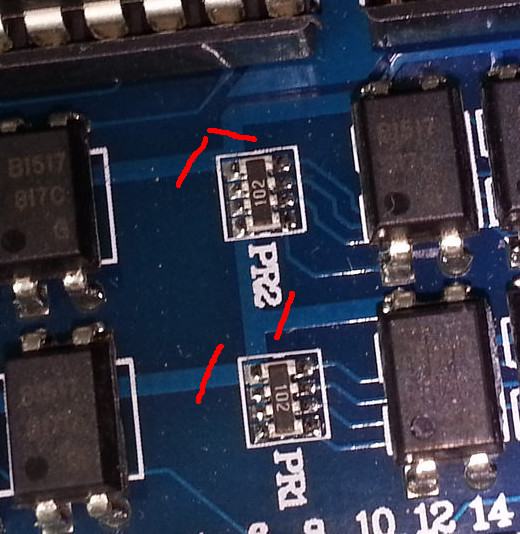

This is the one I have, I took some closeup pictures:
16 Channel Relay Board Back Of Optocouplers by Michael Knight, on Flickr
16 Channel Relay Board Top Optocouplers by Michael Knight, on Flickr
Very nice images!
I haven't used these boards (but might purchase one and give it a try) so I'm not 100% sure this would work. However, this looks like the only spot required to cut the trace in order to isolate the board's 5V regulator output from the 5V pins.
After cutting the trace, the board's 5V regulator should only provide power to the transistor side of the opto isolators and other coil-side circuitry. On the opto LED driver side, it would require a 5V connection to Arduino. After trace-cut, should measure with an ohmmeter and get something much greater than 0 ohm from the 5V pin(s) to pin4 of any opto isolator (transistor collector).
Here's the spot on the top side of the board (hope it works!):

Thanks I cut the trace like this See:
20160320_151907 by Michael Knight, on Flickr
On my multimeter I get some odd numbers twitching when I hold the probes on the 12V power port and pin 4 of the Optocoupler.
I do get a continuity reading between the 12V Ground and the Arduino input grounds is that normal?
20160320_151806 by Michael Knight, on Flickr

Thanks I get a 0 reading if I hold a probe here and on the Arduino inputs for 5V
On the pin just above it I get a reading of 1 on the meter set on Ohms
20160320_151907 copy by Michael Knight, on Flickr
Make sure its not bridged here (all gaps should be clear).

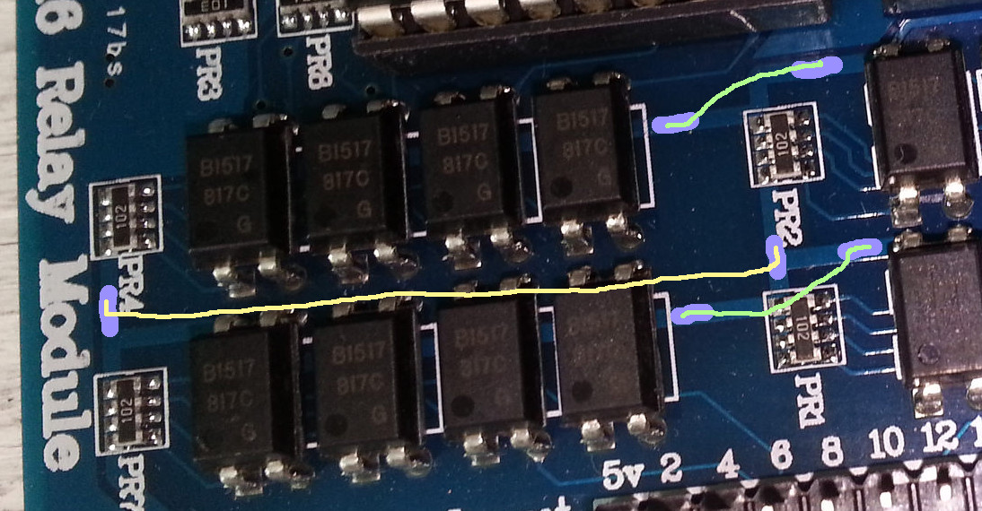

I told you many posts ago that I can talk you through it.
You only have to cut ONE track to opto-isolate the first 8 relays.
Four more cuts and three wires for the next lot of 8.
First picture shows the trace to cut for the first 8 relays.
Cut for the second 8 exactly where I showed, because you have to scrape away some paint next.
Solder three wires to the bare copper as shown.
Connect 5V (next to pin 1 and 2) to Arduino's 5volt pin, and the 16 inputs to the Arduino outputs.
Do NOT connect ground to the Arduino.
Leo..
