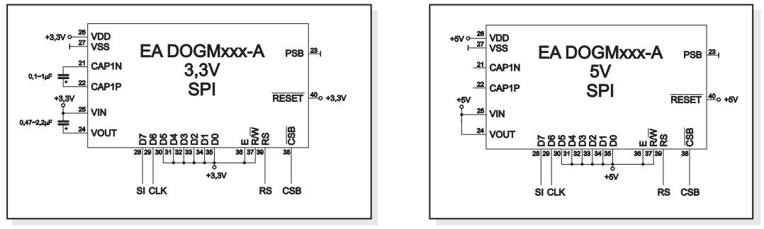

i have decided to try to hook up this display for a small project, but i cant figure out how to hook it up and cant find anything similar. i have tried 3 different methods and no luck, part of the issues is the contrast setting is controlled by a command i think. and i cant find the contrast pin.
the arduino im using is the micro
the lcd model is ea led55x31-r
http://datasheet.elcodis.com/pdf/21/73/217305/ea_dogm081l-a.pdf
can anyone help or point me in the right direction.
Depending on how you want to connect the display to your arduino (8bit, 4bit or SPI) depends on what library you use to control it.
For SPI look here and for parallel interface you will need to google something like 'arduino st7036 library' and try to find something to suit.
what pins would i use on the display for spi?

From the datasheet you supplied.
