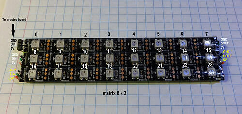

For example: 8 x 3 matrix
Or 8 x 10, with two RGB shields of 8 x 5

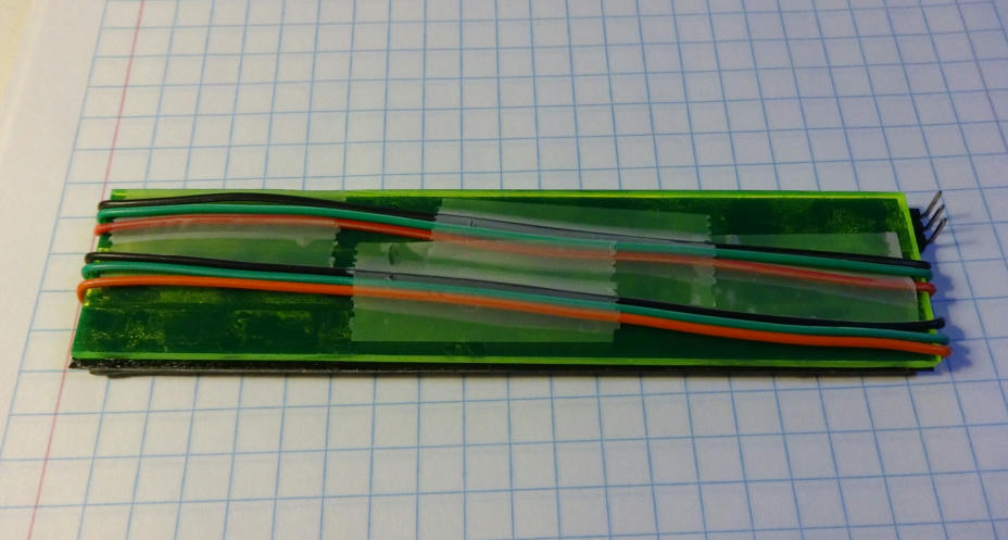

TFTLCDCyg:
Any reason to run the power the long way back along each row?
Yep: get this specific pixel-order in the final matrix
  0   1   2   3   4   5   6   7
 8   9  10  11  12  13  14  15
16  17 18  19  20  21  22  23
How does this matter for the power connections?
Why not just using a classic serpentine (aka "zig-zag") layout?
