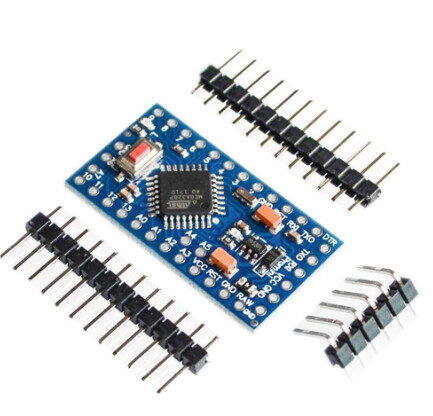

The arduino pro mini looks similar to this:
 ![image](https://europe1.discourse-cdn.com/arduino/original/4X/5/5/b/55be7334c96c02d8b93aebaa0ec30e4eda48e81e.png)

I only said similar because the one I got it from has a [different reset button](https://www.amazon.com/HiLetgo-ATmega328P-Oscillator-Compatible-ATmega128/dp/B07RS911JD?crid=354K91EYN32YC&dib=eyJ2IjoiMSJ9.dTxuef9aWfEgG0HnrhxL0_xxEWlKWqbUvMeSMd-hB27CMcQANgy2h-gF-kS7LT4dLEwnqaUfAZ44CodSlLfLfiKpxhZNpKIaXnSMmOtz3_fClyjojNlkx-NomePXpsbhstiBQP3HXJg3YE5JSxV2na17zOArPBUnnQJc4wM5FB1swezWazgmiQ48OpqhVq3tjKqFipOp_Av6cf7BT7C8TKJ7jKAHpnJf_qKWmwmkGGA.lEyo7PkvOpcTcvRv-eROKM9dJLeabYnLeSFb35zpJIQ&dib_tag=se&keywords=arduino+pro+mini&qid=1748814203&sprefix=arduino+pro+mini%2Caps%2C292&sr=8-2), its the same microcontroller:
 ![image](https://europe1.discourse-cdn.com/arduino/original/4X/9/2/f/92ffc57acd71d330a73e86baa6be99efad11e6e0.jpeg)
As for power, I am using a [ftdi breakout](https://www.amazon.com/WWZMDiB-FT232RL-Converter-Adapter-Breakout/dp/B0BJKCSZZW?crid=31U7C6C5QZ6JP&dib=eyJ2IjoiMSJ9.d5vsloOHRmReaSnQwctqPwaCwp1Wa3n0GVCprQoSFRYq6wLspZZLZh2pIp240rjqMeEi92N7EUFl-GBtpNqMyQLcFB6iEyxiVFX95NSsm2ysSYpymK1YX7mq6Tl-XRPv7HE3HU3CfxSI-BZW8wvJ8FzMCV0E7LYPuk8wvTX1SnO4xqg6r9W_rOkcfrnR-ZHBOqD8iXE1QrFzrKKa3gp-anaQomMlOk3nctKHEowj3u0.L6dbD8kEBObmcHASEofKbDQXle610a68bVW-yFJtQ7s&dib_tag=se&keywords=ftdi+usb+to+serial&qid=1748814372&sprefix=ftdi%2Caps%2C205&sr=8-5) for right now
