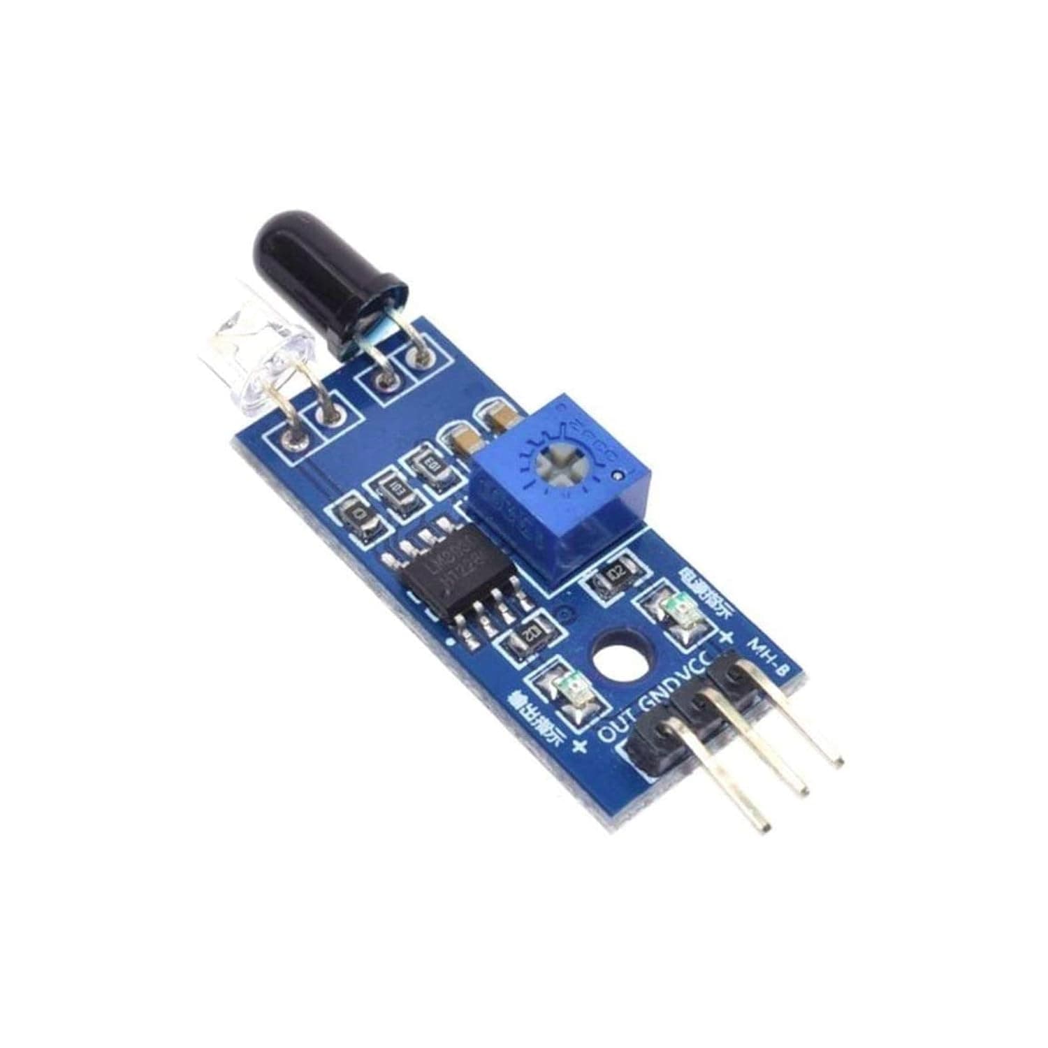

I am really struggling to get two IR sensors to control one servo. The first sensor needs to move the servo from 0-90 degrees whilst the second sensor moves it back from 90-0 degrees.
Firstly is this possible? secondly can anyone help?

Maybe somebody can advise if you show what you have tried; don't forget to use code tags as described in https://forum.arduino.cc/t/how-to-get-the-best-out-of-this-forum/679966#posting-code-and-common-code-problems.
Like this:
if (sensor1) servo.moveTo(90);
else if (sensor2) servo.moveTo(0);

Does this look right?
#include <Servo.h>
Servo Serv;
int pinIR1=3;
int pinIR2=4
int myservo=5;
int val;
void setup(){
pinMode(pinIR1,INPUT);
pinMode(pinIR2,INPUT);
Servo.attach(myservo);
void loop(){
if (pinIR1) servo.moveTo(90);
else if (pinIR2) servo.moveTo(0);

This
won't do what you think. pinIR1 is always going to be true, the servo will always be told to move.
You need to read the pin to find the sensor value.
bool sensorBeSensing = digitalRead(pinIR1) == LOW;
if (sensorBeSensing) servo.moveTo(90);
Your sensor may read HIGH when it is seeing motion.
I am unfamiliar with moveTo(), I assume you aren't making that part up.
The servo will move, but it takes time. If the other sensor be sensing, the servo will make crazy backing and forthing noises and motion.
