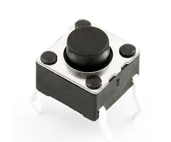

I have a 2 pin momentary button that I want to connect to my Arduino UNO. I have tried all the tutorials online and on here that I can find but it wont work!!
I have tried connecting one side to the arduino pin 8 and one side to ground and enabling the internal resistor and also using my own 10K resistor but still no look!
Any ideas?

Insufficient information. Does the "button" show it works with an ohmmeter? A quick schematic showing how you have the "button" connected would be a big help, as well as posting one of the code examples that doesn't work.
Have you substituted other "buttons"? Result?

Wire diagonally across the button. The way the buttons are designed, two of the four legs are always connected and two of them are switched. When you connect diagonally across the switch you will always get a switched pair.
Delta_G:
You should take your multimeter and investigate your button a little. See which legs are connected when pthe button is pressed and which are connected when it is not.

Thank you sooooooo much for the link! I worked from the tutorials there and its now all working! :slight_smile: quick question.. if I have 4x buttons do I need a 10k resistor for each or can I use 1x for all 4 switches?
