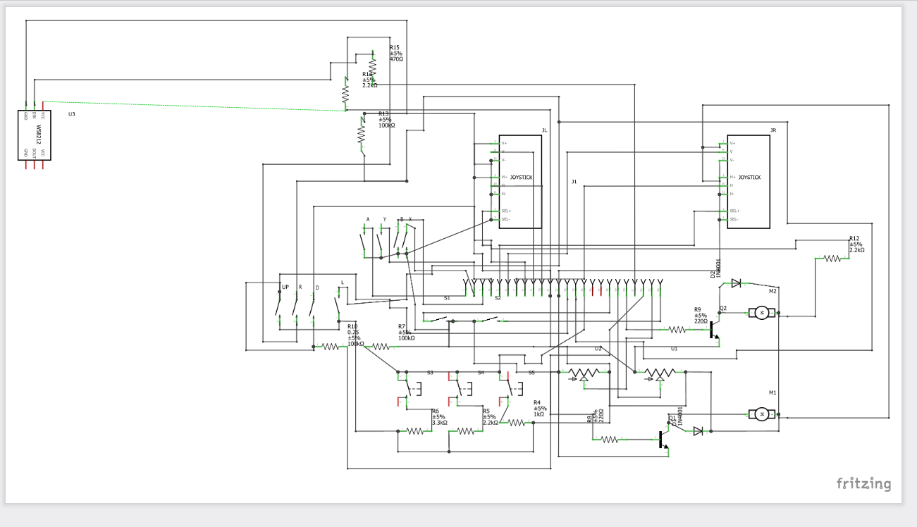

Untitled_Sketch_ANALOG_schem.pdf (1.3 MB)
U1 and U2 are the pots in question
U1 is LT and U2 is RT

Oh DEAR.
This is an excellent example of the reason for my feelings towards Fritzy.
1: try disconnecting EVERYTHING else.
2: draw a schematic of how JUST the two pots are connected to the arduino.
3: Run this code, that does a dummy read after EACH change of input

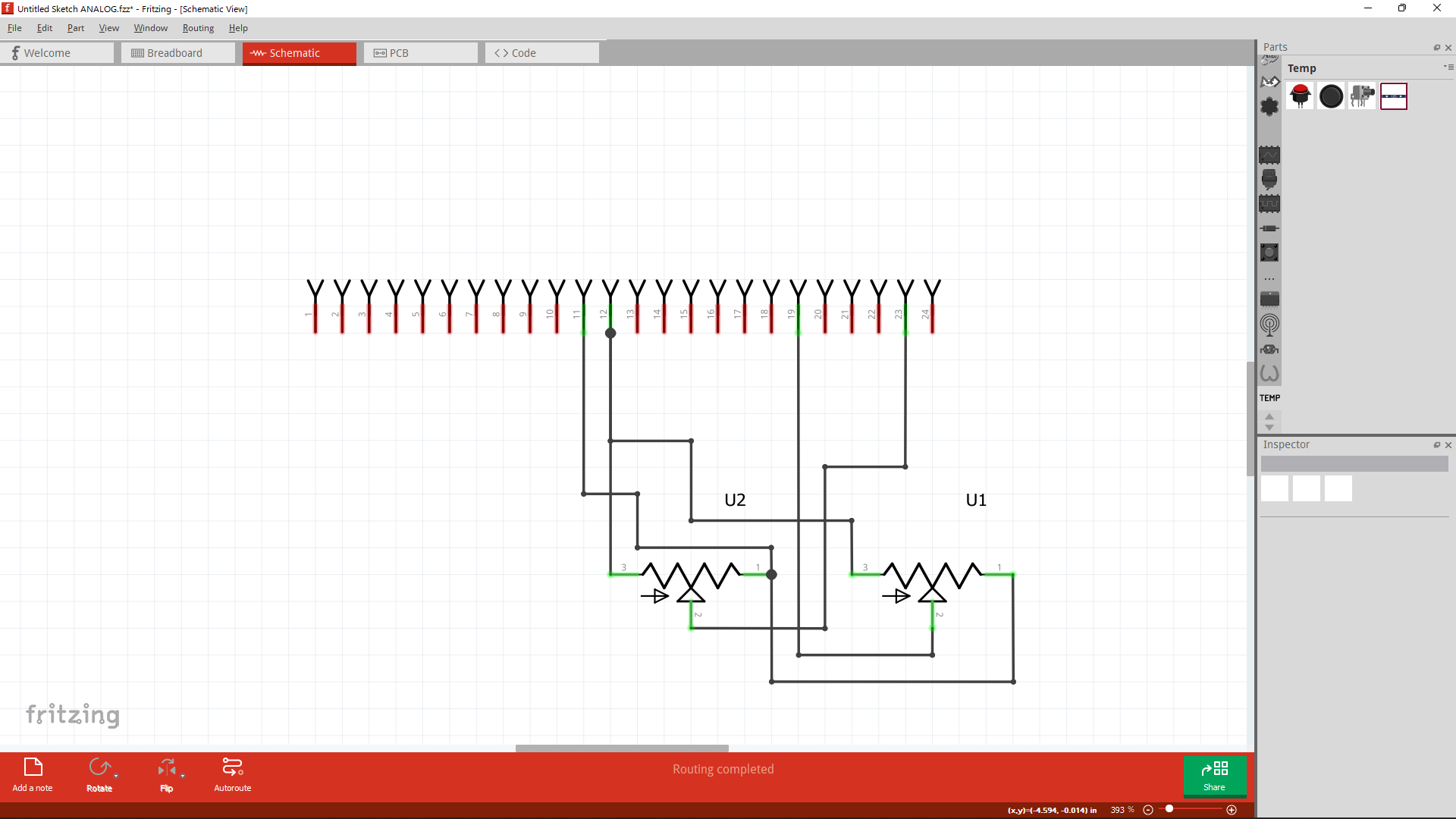

here's the schematic
solution :
buy new pots.
the affected pot was deffective and not 10k, but 10,5k

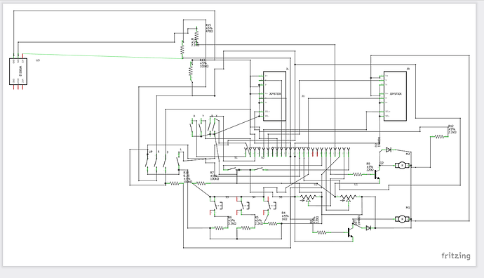

Well its a start; it doesnt show what the 11,12,19 & 23 are; I'd guess - but why should I have to?
.. Do I need to say you need to include your "SETUP" as well?
.. then copy what is printed to the monitor, and post it.
