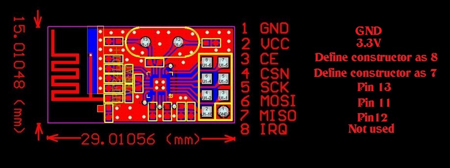

Thanks PeterH, zoomkat for the solution. Two serial monitors are opened as I wanted. The sketch is behaving in a weird way. After uploading the TX & RX sketches, both the PIN13 LED should glow but the LED of TX board is now glowing in none of the UNO boards (I burnt the UNO bootloader in my dueminilove board, I think I have 2 UNO boards now.)
I have made all the connections as described (Image included) & double checked them. when I open & type something from the TX serial monitor, nothing appears in the RX serial monitor. The library & examples are attached herewith the post.

If it seems to be behaving strangely I suggest you do a sanity check of the hardware by uploading a sketch that just writes a fixed message to the serial port to confirm you are successfully uploading the sketch and have basic serial I/O working. Once you know that, you can use serial trace messages to work out what is happening inside your transmitter and receiver sketches.
