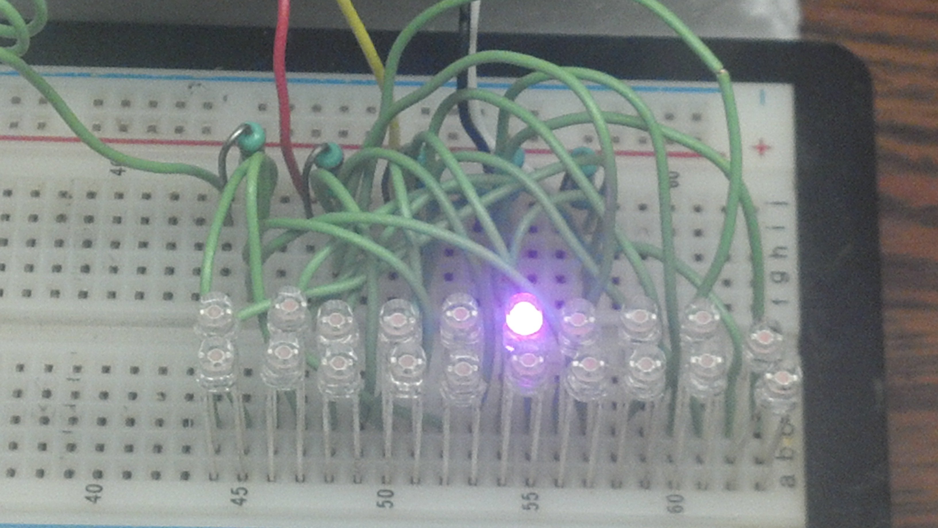

20 LEDs all ina row... Charlieplexing style! How to address each??
I don’t know how to address each led. C++ and I are not friends. No idea.
I try to scrap bits and pieces of code.
They run now… but not in an order I understand.
charlieMatrix3.ino (554 Bytes)
Followed this picture…
Ok, dig this, by why do they go out of order on my breadboard? I wired just 20leds to 5pins. It blinks: 1 2 9 10 15 16 19 20 3 4 11 12 17 18 5 6 13 14 7 8
And how do I address them individually??
It’s a jungle in there baby

Oh and want to charlieplex for wire management. Only need to get 5 wires to the site from batteries/arduino location.
This was the best reply:
You have them wired like this:
—2— —3— —4— —5— —2— —3— —4— —2— —3— —2— PIN#
1 2 3 4 5 6 7 8 9 10 11 12 13 14 15 16 17 18 19 20 LED#
—3— —4— —5— —6— —4— —5— —6— —5— —6— —6— PIN#
That looks a lot like the schamtic previously posted in this thread. And, that’s a handy way of making a schematic, but it’s certainly not the only way to wire the LEDs. When you charlieplex, you have to match your code to your wiring.
Here’s the arrangement that I had in mind:
—2— —2— —2— —2— —3— —3— —3— —4— —4— —5— PIN#
Notice that it looks a lot like the code: the upper pins are the slowly-varying index, and the lower pins are the rapidly-varying index.

I have this code:
int NLEDS[20] = { 1, 2, 3, 4, 5, 6, 7, 8, 9, 10, 11, 12, 13, 14, 15, 16, 17, 18, 19, 20 };
int LEDArray = sizeof(NLEDS)/sizeof(int);
void loop(){
for (uint8_t i=2;i<=NLEDS;i++) {
pinMode(LEDArray*[0],OUTPUT);*
_ pinMode(LEDArray*[1],OUTPUT);_
_ digitalWrite(LEDArray[0],HIGH);
delay(300);
digitalWrite(LEDArray[0],LOW);
digitalWrite(LEDArray[1],HIGH);
delay(300);
pinMode(LEDArray[0],INPUT);
pinMode(LEDArray[1],INPUT);*_
----- But it doesn’t work and I don’t understand how that can address each one.

Would it be easier to just rewire? It is just on a breadboard. Was hoping to understand code. Not sure how to go about understanding the code.
Might just rewire, I like hardware.
But if I just rewire… how does the code address each led?
Does it start at 2 and 6 and increment both equally one at a time?

Your call. Do you just want to make this one work, or do you want to learn how to make this kind of stuff work?
... how does the code address each led? Does it start at 2 and 6 and increment both equally one at a time?
No. Work your way through it: i starts at 2, j starts at i+1 = 3; then j goes to 4, then 5, then 6. i goes to 3; j starts at 4, goes to 5, then 6. And so on. Looks like you're not entirely clear on how a loop works.

I can see how the numbers given can access the leds separately but don't know how to tell it those numbers with out it not working/verifying.
And 3 high and 2 low for 2? Sweet, if that is it.
I thought you had it there.
Would like to make it work and want to figure it out. Telling me how i and j move was helpful!

So wrote this and modified x and y to determine the values of the pins to the leds. Wow, what a pretty pattern!
void loop () {
   uint8_t n = 0;
   for (uint8_t a=x;a<=6;) {
     pinMode (a,OUTPUT);
     for (uint8_t b=y;b<=6;) {
       pinMode (b,OUTPUT);
       digitalWrite(a,HIGH);
2,3=1
3,2=2
3,4=3
4,3=4
4,5=5
5,4=6
5,6=7
6,5=8
2,4=9
4,2=10
3,5=11
5,3=12
4,6=13
6,4=14
2,5=15
5,2=16
3,6=17
6,3=18
2,6=19
6,2=20
