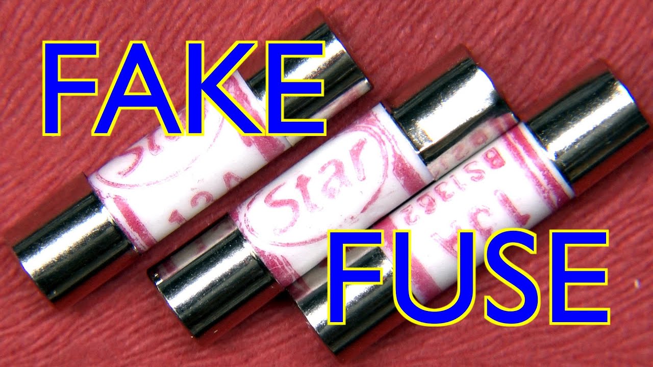

Interesting YouTube testing fake and original 200A HV fuses.
