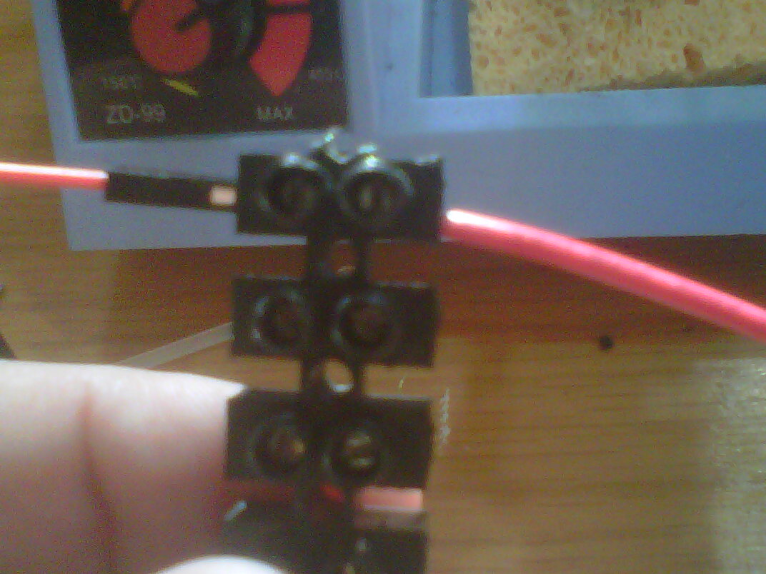

Get some terminal block strip
Okay, "terminal block" seems the terrific thing to search for here as well. :-)
Followup question; what's it called if the terminals aren't isolated from each other? That is, in a terminal block strip, you have pairs of two screws that aren't insulated from one another. If all of the screws were electrically connected, what words should I be searching for? (Trying to tie together ten or so things for a common ground.)
There probably is such a thing as that, but you could just jumper the terminals on the strip
You need this. They come in all shapes, sizes and colours.
Shpaget, I can't easily buy what I don't have a name for; what's it called? :-)
Interior, day. Talldean enters shop armed with photo from the forum..... Talldean (showing photo): "I'd like some of these please, Mr Shopkeeper, but I have nfc what they are called" Mr Shopkeeper: "Certainly Sir, what colour would you like?" Talldean: "Blue" Mr Shopkeeper: "You're in luck, here you are" Sound effects: Ka-CHING Exeunt
They are called bus bars or bus strips.
