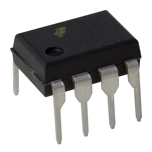

You can use this simple circuit for AC detector.
For 230V, likely use 30K resistors instead.
The output, what I show as D4, goes to an Arduino input pin with pullup resistor enabled.
UL Recognized
V indicates "VDE Certified" (VDE0884, whatever that is)

Are there any vendors providing such modules for din rail mount because i couldn't find one (at least for a decent price). If I would create such a circuits there are possibilities for an electric shock, fire hazard, ...
