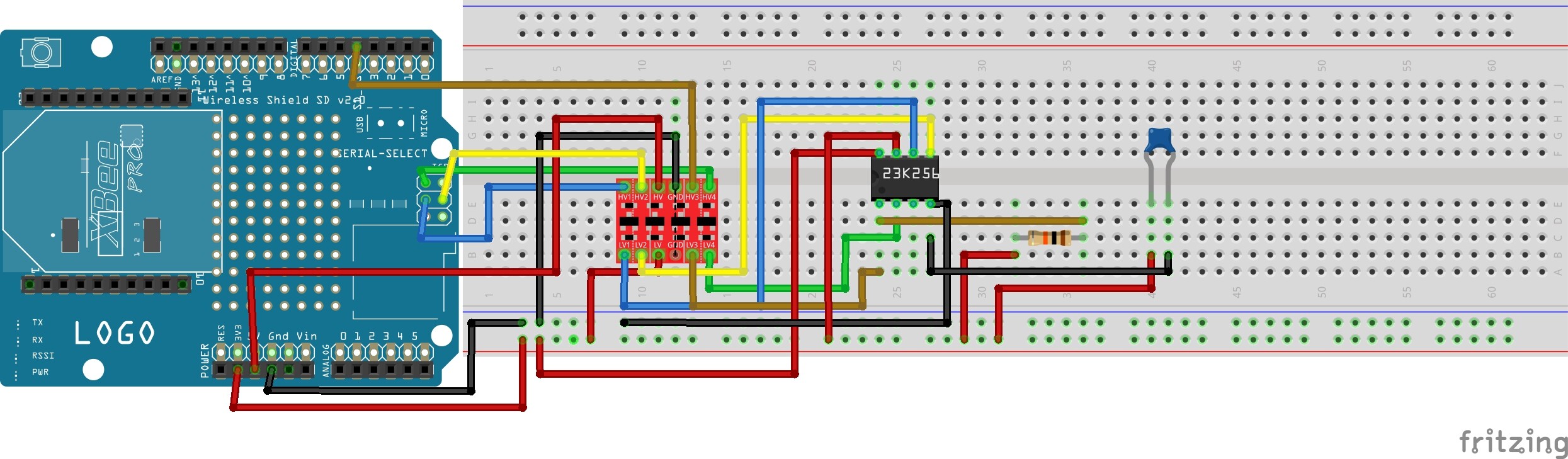

I have a Problem with the 23K256.
Im using a Arduino Leonardo with a Wireless SD Shield. I know that the SCK, Miso and Mosi are now on Pins 13,12,11.
I also use a Logic level converter.
When I use the Example code the serial monitor show me "ram error...".
Is my circuit wrong or is the Library not compatible?
Its a important project, so please help me.

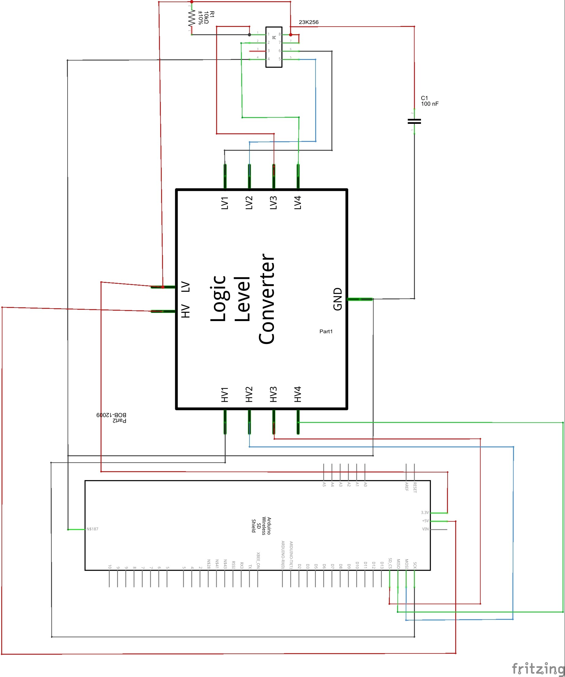

If I read your 'schematic' correctly, you have all the control and data lines being level shifted from Hi to Lo. Problem is MISO goes from Slave to Master, not Master to Slave like the others.
Just connect SO on the 23K256 directly to MISO, or level shift from Lo to Hi.
As an aside, I, and most others on the forum, hate fritzing, but that is beside the point.

Ok I will try it. The LLC is a bidirectional Converter.

I try it and it doesn't work with the shield and without the shield.
I do something wrong. :confused:

Sry I doesnt see your post earlier. I use this one: https://www.sparkfun.com/products/12009

I am definately no expert but you have SS set as pin 4, but you have the CS of the 23K256 connected to SD_CS on the schematic and pin 4 on the fritzing. Also, as I understand it, the SS pin has to be defined as an OUTPUT using pinMode.
