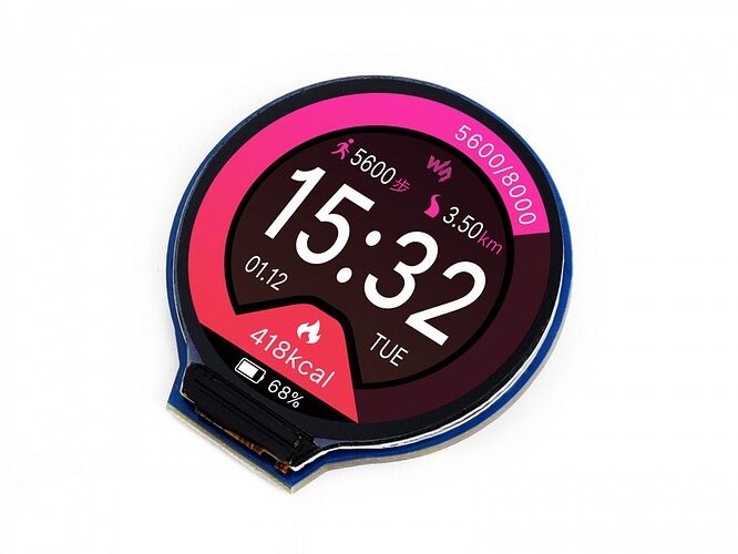

I recently purchased the "1.28'' IPS TFT LCD Display 240x240 Round Circle Screen for Smart Watch" here: [buydisplay](https://www.buydisplay.com/1-28-inch-tft-lcd-display-240x240-round-circle-screen-for-smart-watch)
The site gives sample demo code (download) that is written by the manufacturer of the display "EastRising" and also links to the GC9A01 driver datasheet [here](https://www.buydisplay.com/download/ic/GC9A01A.pdf).
Problem I have is that the demo code references command codes in the display initialization that are not documented in the driver datasheet. I would say approx 70% are not documented.
I contacted BuyDisplay and they said "_Unfortunately we don't have more specific datasheet for reference, The chip supplier only provided that datasheet to us._"
I have not yet run the demo code but I am sure it will work, but I wanted to understand exactly what all the initialization commands are doing.
I have attached the GC9A01 sample driver code (header file) that shows the initialization code starting on line 385.
Example command in demo would be:
Write\_Cmd(0x88);
Write\_Cmd\_Data(0x0A);
I have looked at a number of other driver chips ST7789, ILI9488, ILI9341 and none have any commands in the 0X80-\>0x8F range or 0x62-\>0x67 shown in demo code.
I have tried to contact EastRising, but I am not hopeful.
Has anyone seen this before?

It looks like it is a regular MIPI-style controller like ST7789.
Your "program" contains the initialisation sequence.
The subsequent "user" commands will be just like ST7789, ST7735, ... or any other SPI controller.
If you have the proper datasheet, please post link or attach PDF if \< 2MB. Or PM me if too big.

Undocumented code (often called illegal opcode) has been around for a few decades: [Illegal opcode - Wikipedia](https://en.wikipedia.org/wiki/Illegal_opcode)
Often time if there's little room left in the CPU or controller chip's design, the dev will slip in an extra command or 2. Often times, it's not published in official documentation because it's extra info that weren't planned. Other time it's unintended design glitches that aren't dangerous but can be exploited for extra feature or extra speed. And there's time people just got lazy when updating the official datasheets and overlook a few supported codes.
