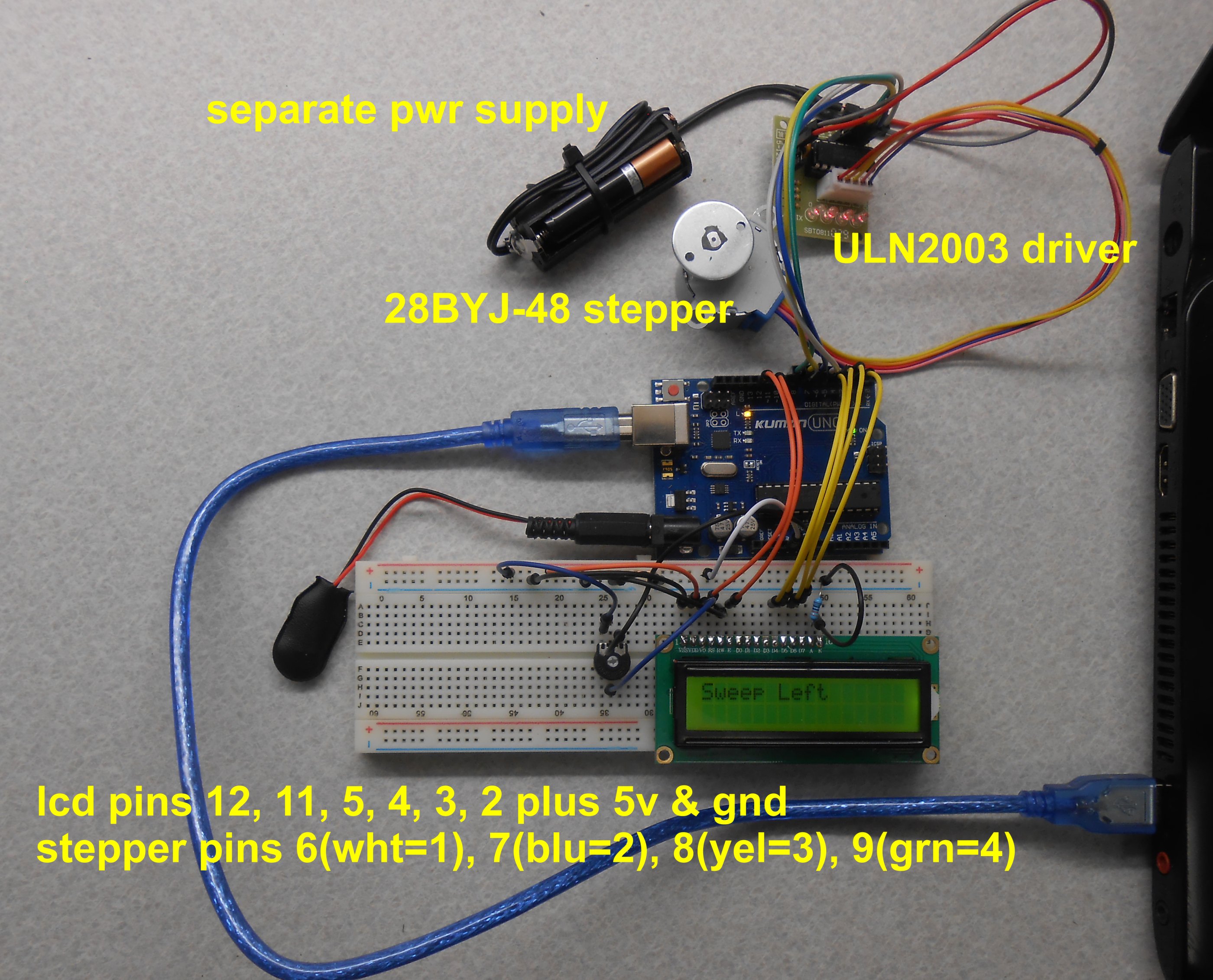

Further to my post of the same subject today. Many thanks to Terry King 'terry@yourduino.com' for the CW/CCW sketch...it worked great CW & CCW then I left it alone for a while and came back to it later and the stepper would only move CW. My indicators showed the sketch loop was performing the CW and CCW OK. Please see attached photo with setup including an lcd to indicate L/R movement. IDE 1.8.0 and sketch below. I made sure the wires are 6=1, 7=2, 8=3, 9=4 for the stepper with same in the sketch definition. I was quite happy with the progress and looking forward to my next step...so, now disappointed.
My thoughts:
  1. did something happen to the IC on the 2003 board?
  2. is the 28BYJ-48 is low-end piece of junk?
  3. if #2 is yes, can anyone suggest a good stepper model?
  4. arduino compiles and uploads A-OK for lcd and serial operation.

Why are you double posting ?
http://forum.arduino.cc/index.php?topic=447127.0
Ask a moderator to merge your two threads.
because it is a DIFFERENT issue.
1st post requesting help in obtaining a sketch that would provide CW & CCW stepper movement.
2nd post stating that I may be having mechanical and/or electronic issues.
NOT double.
