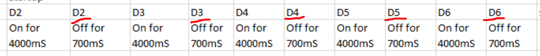

the two arrays just sequence the led's from outputs D2 to D7 with intervals of the time set for the mari interval but between the transitions to the next sequence all outputs in that array turn off for the off time duration so they cycle from 1-6 down the array and start at 1 again but there seems to be a delay at the start and also only starts at array row 2 instead of 1 but after the first sequence pass its ok, and also there's a delay from the 6th sequence to starting at 1 again. thanks
Hi
The idea is at startup the array table scrolls down from top to bottom using the index then restarts from 1-6 again and the same for the cls array, all the 1s in the table are relay/led outputs I'm using then they are turned on or off from the relay manager based on what sequence/index its at.
any help with fixes is appreciated and will test. thanks

Hi, Yes that's roughly what it is to do sequence outputs 1-6 with off times so as we go to the next sequence down the array the outputs are all off for that particular array, i maybe didnt need to use arrays to do this. The code seems to work but it starts the array at row 2 instead of row 1 and there is a delay before it even does that.

i needed two sequences running simultaneously at two different speeds with off times mostly to ensure the previous output is off for at least 500mS before the next output turns on. the idea was the sequence = the index then whatever sequence then program was at the index could turn the relay outputs on or off with the array table contents. Thanks
Where I've underlined pin numbers, should all of D2-D6 be off for 700ms?
What are the requirements for D7 (I thought it was asssociated with D2 to D6) because there's a comment in the code "Mari on D2,3,4,5,6,7"
Can you do a similar diagram for D8 to D10?
With those two diagrams I (or someone else following this thread) could quite quickly write some code that would do what you want to do.

Sorry it is from D2-D7 i missed the D7 off the illustration.
The CLS is the same just different on time/sequence time of 7000mS and only 3 outputs D8-D10. Thanks
