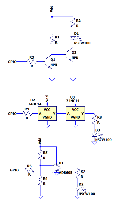

A simple buffer would do. This could be something like two transistors, a logic gate (a single non-inverting one or two inverting ones in series), or a comparator/opamp.
If the GPIO is an output, it's very simple since of course all you need is a resistor and an LED.

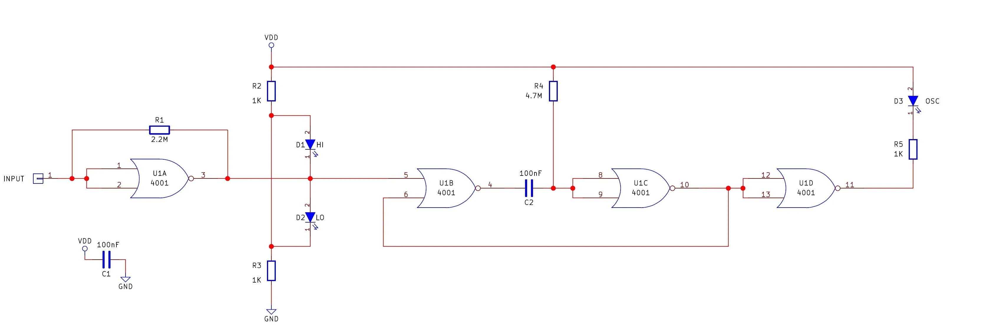

It is easy to do and there are many versions of this. Try this one:
Here is the link to give you instructions:
https://www.allaboutcircuits.com/projects/diy-tools-build-your-own-logic-probe/

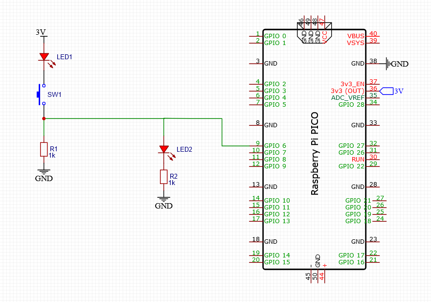

This was my original idea (which won't work):
I'd hoped that LED2 would show me the output state of GPIO6 but of course my circuit is bad because when I close the switch, the LED drains straight through GPIO6 without limiting the current. My circuit is complete rubbish but I hope it gives an idea of what I was trying to do :slight_smile:
The reason I'm showing you this is just to give you an idea of what I was hoping for - something that shows the input (ie. LED1 when the switch is closed) or the output (LED2).
I'm not sure how the data input to the GPIO would connect to your 3 examples.

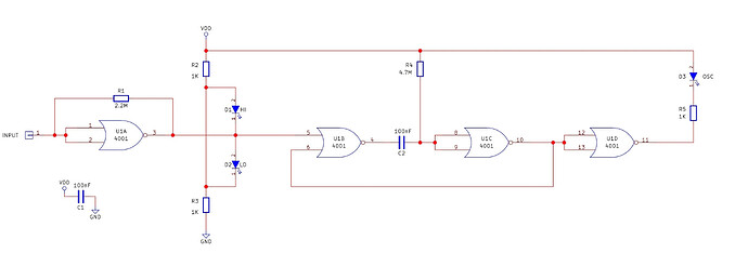

Thanks - I might give this a try. Should work the same with a 7402 shouldn't it?
Well, 'rubbish' is of course a bit of a particular choice of words - but yes, it's not very effective. And no, it's not entirely clear to me what you're trying to accomplish. It appears to be an attempt to use GPIO6 as an input for a push button, but you refer to it as an output.
If you're trying to use GPIO6 as an input, consider this:
Wire a button between GPIO6 and GND. Nothing else.
Configure GPIO6 to have its internal pullup resistor enabled.
If desired, connect either of the options I suggested to GPIO6 allowing you to monitor the input with the LED.
However, the LED monitor is really pretty much superfluous since in practice reading a button input from a GPIO as described above is totally reliable.
