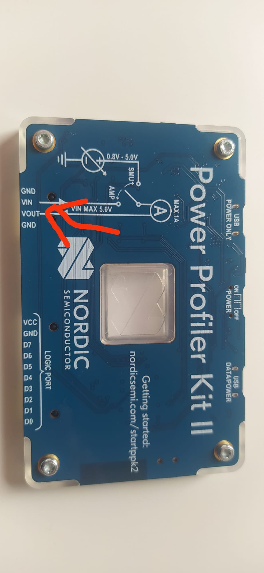

I send you an image of the Power Profiler Kit 22 that I am using and the VOUT pin that I use when I try to supply a voltage and measure the current consumption/execution time for different states of my Arduino board.
Why is it printed right on the front of the image you attached MAX is 5.0 volts?
Are you using the software for the PPK2?
Did you watch the video on how to enable up to 5 volts out?
As I mentioned before, the external power source that I will consider for my project is not PPK2 (and it can only provide 3.3V max), but PPK2 is used just for testing. I am able to run the code now when I removed all parts related to the Serial monitor (probably my code was stuck with Serial.println/Serial.begin) and I was not able to see any LED blinking and other expected behavior. Now, when I removed all parts related to Serial I can see what I am expecting. Yes, I am using Nordic software to see the results of my experiments (nRF Connect for Desktop).
Ok, now I understand. Yes, the entire board runs on 3.3 Volts.
