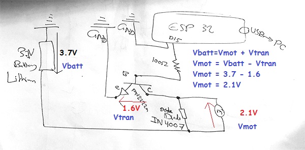

You will drop 1.6V of your 3.7V across the transistor, that is why you cannot get full speed.

Attached below the sketch of the circuit with all components used.
Problem: the circuit works but not as required. the motor spins between 0-255 and it changes the speed but when given 255 value the motor doesn't spin at maximum speed. When i disconnect the motor and connect directly to the 3.7V battery it spins at maximum speed.
Components
Controller: ESP32/Arduino Uno Transistor: PN2222a Diode: IN4007 Battery: Li 3.7 Volt 380 mAh Resistor: 100 ohm
The resistor connected at base, the ESP32/Arduino is connected to the laptop.
That motor draws 1.2 Amperes when it starts up.
As MarkT and Tom suggested, the PN2222A is totally inadequate.

Could you help me to find an alternative? I read that logic-level Mosfet are the best option here. But unfortunately I couldn't find any where I live, tried the IRF510N Mosfet but it didn't work as it didn't get enough voltage since it requires 10V

OPs circuit, thankyou, with explanation of volt drop across transistor edited in for PWM value = 225.
