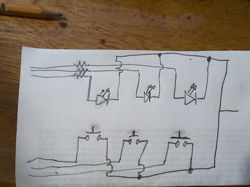

Make a drawing (or sketch) of your project, even freehand, so that we can better understand your needs and help you better.
Been quite a few years sense I did drafting.

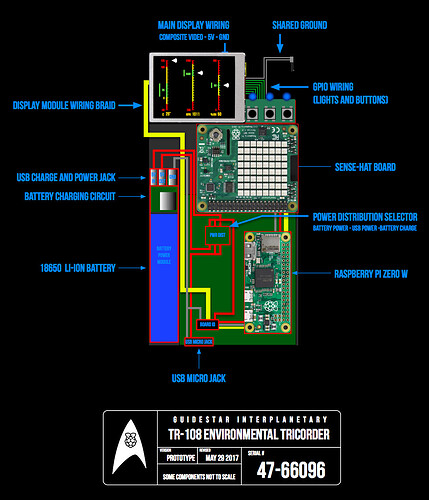

This is the whole (original) project.
I'm not using the SenseHAT, and I didn't get the same screen (discontinued)

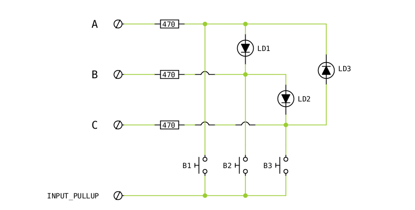

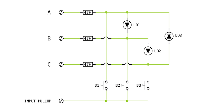

Read four keys with three I/O - PCB with IR and 4 Buttons - #37 by Claudio_FF (post #38). You could just omit one of the keys.
Read up on charlieplexing for the LEDs.
A B C Function
L - - Read B1
- L - Read B2
- - L Read B3
H L - ON-LD1
- H L ON-LD2
L - H ON-LD3
"-" are Hi-Z outputs

An improvement in the level of detail. But still not great.
Have you read the forum guide in the sticky post at the top of most forum categories?
What we need is a schematic (not a wiring diagram) showing how this display and the other components are wired to the Arduino/ESP.

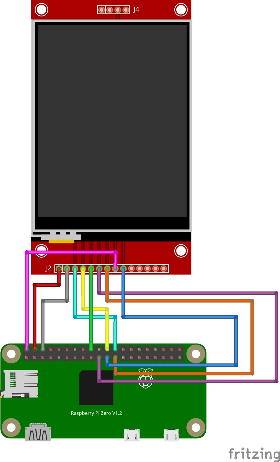

Assumably it's going to be the standard pin out
LCD - RPi
SDO(MISO) - MISO/GPIO9, pin21 (common)
LED - 5V through 1k resistor, pin 2 (common)
SCK - CLK/GPIO11, pin23 (common)
SDI(MOSI) - MOSI/GPIO10, pin19 (common)
D/C - GPIO24, pin18
RESET - GPIO25, pin22
CS - CE0/GPIO8, pin24
GND - GND, pin 6 (common)
VCC - 3.3V, pin 1 (common)
I'm having problems find how to get the touch pinout. Got a month to figure it out
Not good with Fritzing, but this might help?
Color is random, so is not be standard
