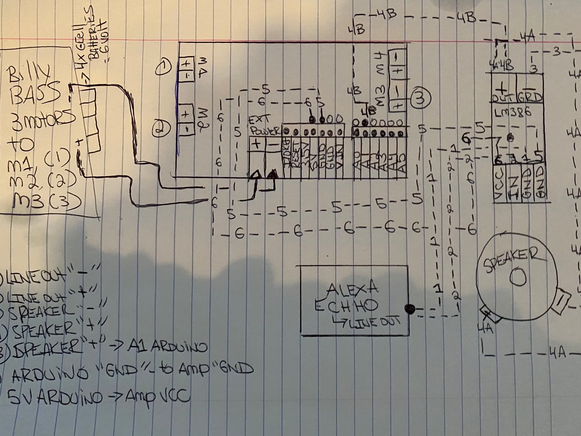

Time to post a schematic of your project. Hand drawn is often better than what you'll come up with if you have to struggle with a real schematic drawing program. Please don't use Fritzing to do this. Pencil and paper...
a7
Here it is
So signal flow as far as everything else is fine, everything is registering except strong motor movement. So with everything else being fine, trying to figure out why the battery supply would be Insufficient. And yes, the Uno is plugged in separately.
Battery to the motor shield is coming from 4 - c cell batteries brand new , totalling 6volts.
Haha, I remember that drawing. Someone stressed the importance of labeling your signals and you took it to the next level…
There is no need to use dashed lines with a label repeatedly repeated along its length.
Otherwise, your diagram gives us something to work with.
Solid unlabeled lines between clearly labeled points woukd be easier on the eyes.
Part of the diagram is off the screen, and I think you’ve to,d us the C cells aren’t in your diagram but are attached to the motor shield - not sure what’s going on/represented by the block furthest on the left.
How much current will the motors draw when full on? How does the C cell battery stack do with that load? Do you have a meter you can use to spcheck voltages and currents?

lol yes im trying haha.
C cell batteries are on the top left of the picture
Basically a 4 bank of C cell batteries totalling 6volt.
I think that’s my issue is not knowing these old motors in here what they require, although this project has been done lots with just this stock battery pack. , the talking fish is over 20 years old, but I know the motors themselves work fine. Hard to find documentation of what they are
Bro we’re good for test
I took it apart , cleaned up the terminals etc and were in business all motors work as per the test sketch.
Thank you for all your help. I’ll continue to pole away on my side
So it was as easy as dirty terminal connections? Nice!
