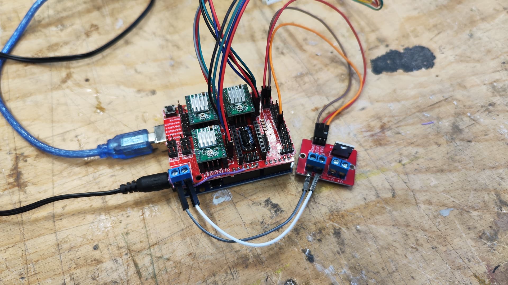

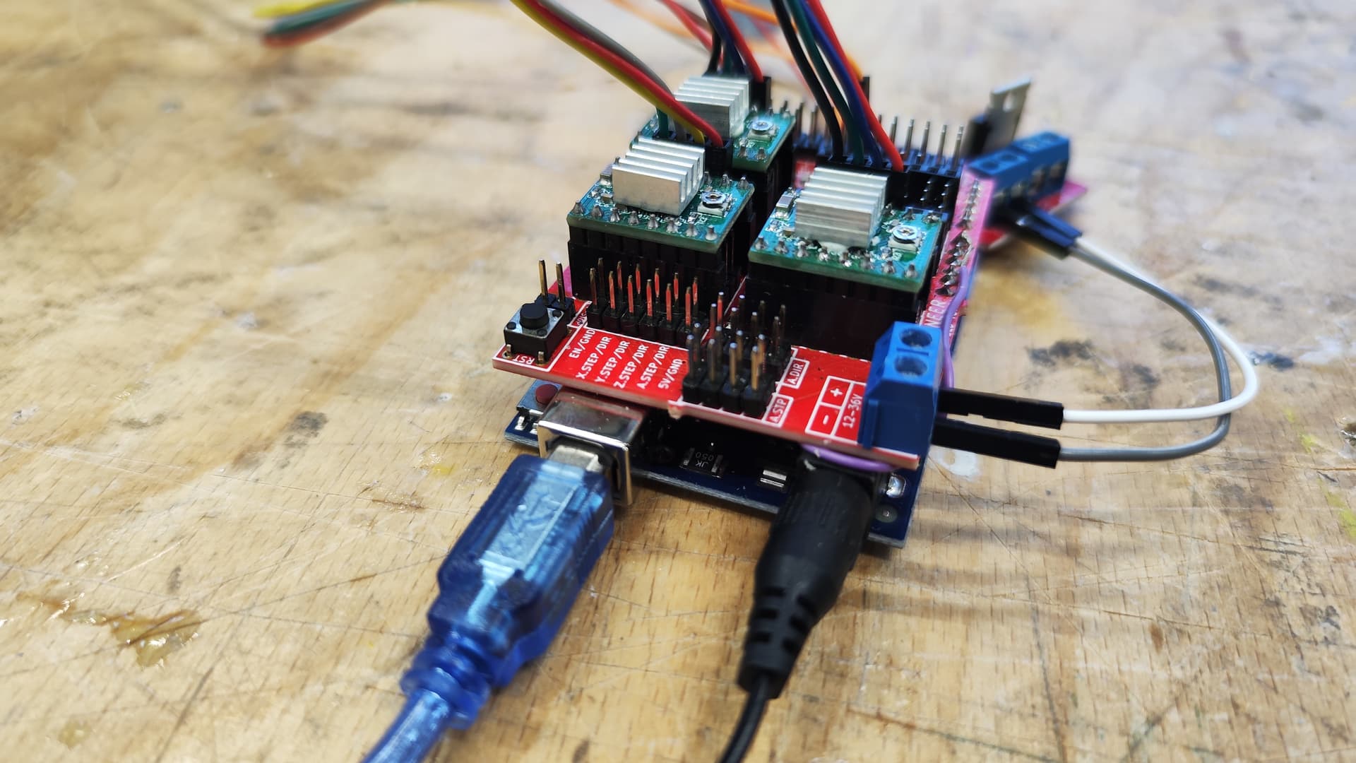

In the pictures you can see the setup I was thinking of. I have an arduino uno r3 with a cnc shield on top. On this cnc shield there are 3 stepper motors (NEMA 17, 1.7A) connected (next to the stepper drivers). In addition I've connected a IRF520 MOSFET module to this cnc shield, to which a 12V, 300mA solenoid is connected via the V+ and V-. I was wondering if this is a setup I can safely use to control these three steppers and the solenoid when having a single 12V adapter as the power input. It is not necessary to have all four run at the same time, for my purpose it is enough to move two steppers at the same time, then the solenoid, and then the third stepper for example. Would this be possible? Or would I for example need to use a 2nd adapter for the solenoid?
Use IRL, logic level MOSFETs. IRF might not switch well enough.
Okay, would this setup work apart from the mosfet? Like would there be enough power to control the solenoid and the steppers etc.?
I was also able to control the solenoid using this irf mosfet
Haw many Amps is the 12V adaptor?
It is 2A
That enough for only 1 motor.
So it could be possible to move one stepper, then another, then the solenoid, and then the third stepper. Also before, when I didn't have the solenoid connected, I was able to control all three steppers simultaneously. Why would that not work anymore when the solenoid is connected?
What was the current limit set to on the drivers?
I don't know honestly, I got the cnc shield with the drivers delivered to me and never changed anything. Any way I could find out?
Need to know the part number for the driver, should be in the datasheet/instruction manual.
Looking the driver type up online I'm finding 1A
What is the driver type?
