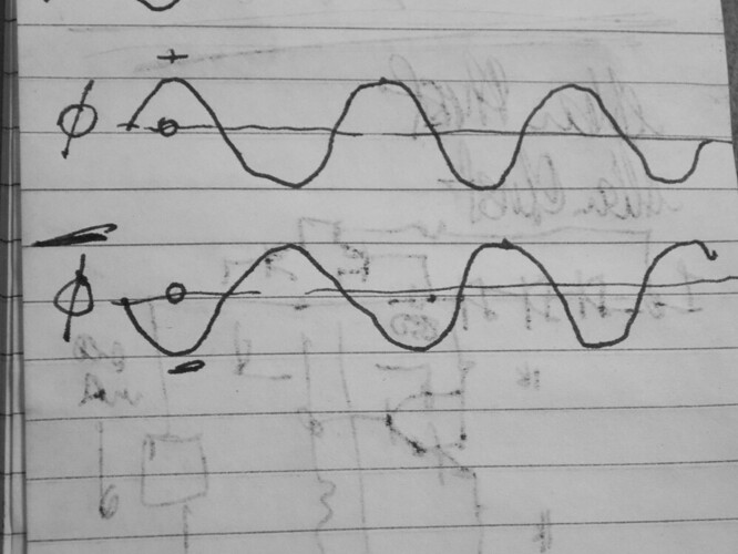

I had 2 x MOTs with both primaries and secondaries connected in series.
This was giving me about 86V AC / 116V DC
I added another MOT to boost the voltage a bit and increase the saturation safety margin.
Except that no matter which way I flipped both the primary and secondary coils on the third MOT I was only getting about 40V AC total.
It was only when I reversed the connection on the third primary that I got 100V AC / 140V DC
I can't get my head around why this would work with AC current going into the primaries.

This is the actual device. It is just 3 transformers with both primaries and secondaries connected in series.
Except that the third one (with the weight) has the connections swapped relative to the other 2.
When wiriing transformer secondaries in series together, they must all be in phase for the voltages to add - think of wiring dc cells in series.
Any one of them reversed will subtract it's voltage, not add.
Note if wiring them in parallel, if you get it wrong there will be a big bang!
Allan.

swapping primary connections is the same as swapping the secondary - it inverts the phase.
Allan
I still don't get it Alan. It's alternating current and has no polarity so how is the phase inverted by inverting the connections? Are you able to explain it to me via some sort of diagram?
See the drawing - The upper sinewave ( say) is the input - and the phase of the output from your transformer will be the same if wired in one way ( though the voltage will be different) . Reversing either the input or output will give an inverted sinewave - the lower trace.

Well, sort of. An AC signal's instantaneous voltage varies with time as shown above.
Say at time = 0, the voltage of the mains L is at 0V with respect to the N. Since mains frequency is ( in the UK) 50Hz, after 1/50th second it will get back to 0V - 1 complete cycle as shown above.
At any point in between it varies as shown in the diagram. For example, after 1/4 of a cycle it's at it's highest +ve value. At 1/2 cycle it's back to zero. At 3/4 cycle it's at it's highest -ve value. And so on.
If you swapped the L and N, you'd get the reverse of those readings - as in the lower diagram. Just as if you'd reversed the connections to a battery.
Any help?
Allan

If you reference one side of your voltmeter to N, then the two measurements will give you the upper of my 2 drawings ( about 250vac ) , and 0v respectively.
Allan
