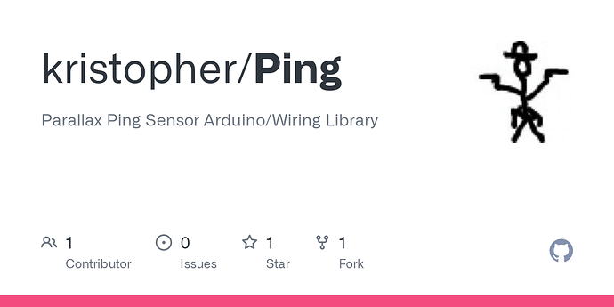

I don't have the Ping, I have the Chinese HC-SR04, but I googled it for you:
First link shows you how to use the Ping sensor. Pretty in-depth.
http://tronixstuff.wordpress.com/2011/11/28/tutorial-parallax-ping-ultrasonic-sensor/
2nd link is to a library so you can just do a #include on your programs and issue a simple command.
https://github.com/kristopher/Ping
I haven't tried either one, since I don't have a Ping. You may need to find a newer Ping library if that one doesn't work with Arduino 1.0. If you have more questions, I think I'd start another thread in the Sensors forum.
