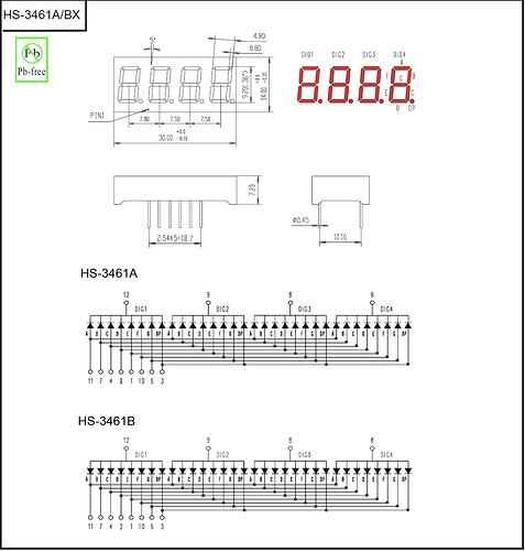

I have this 4 Digits 7 Segments which has 12 pins and it has this code written on it: CAI3461BS. So i searched for its specification and i found this
http://www.datasheetarchive.com/indexer.php?file=DSASW00381837.pdf&dir=Datasheets-SW20&keywords=HS-3461A&database=user-highscore#
(sorry about the link, need to download it)
Or the picture and the pdf is on the attachment...
I tried this connections and code but it did not work at all.
Can any one please suggest a link on how to connect this 4 Digits 7 Segments with 12 Pins and a proper sketch to make it work..
please..
Thank...
3461b.pdf (103 KB)
CAI3461BS
It is a 3.4" 7-segment display ("34"). "61" indicates the display type - there are many different types, like 41/42, 51/52, 55/56, 61/62, etc - google for more. "B" is common anode ("A" is common cathode). "S" I think is with the dots. "H" is with two dots, for hourly display.

I tried googleing how to make it work for example a simple timer counting seconds.. I tried one example but the numbers gets all messy on the display... i think i'm not be able to figure out which pin goes to which pin ... =(
Is there any good sketch for this type of 4 digits 7 segment display you could suggest.. i'll be grateful.. :smiley:
Thanks..
Post the code you tried, lets see what's going on.
Here's an example connection method.
Multiplex by driving 1 anode high and 1 cathode low at a time, cycye thru all 56 segments with each on turned on a short time, say 750microseconds each for a 24Hz refresh rate.
"Persistence of vision" will give the appearance of all digits being driven.
