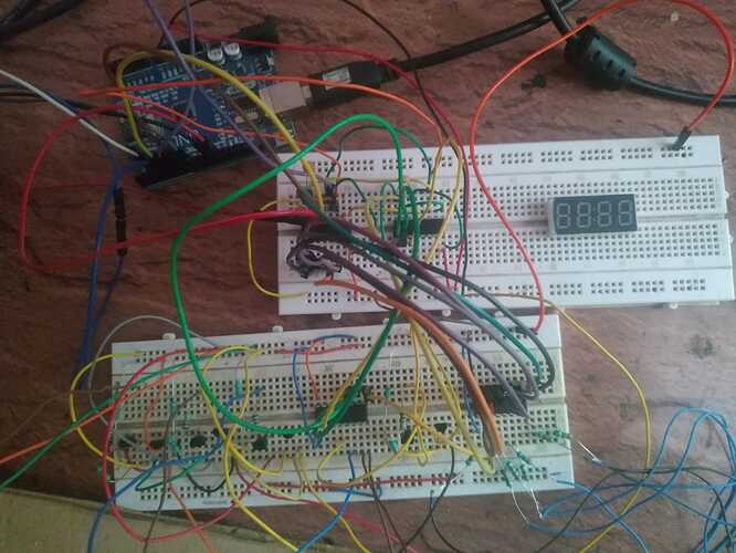

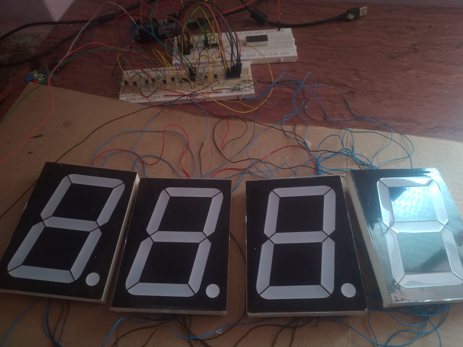

Successfully tested on small 4 digit CA Display.When tried to use 12V, 4 Inch high Display facing challenges.
As 2 Nos. 74HC595 used with small Segments which is not possible to directly used with 4 inch due to HIGH Current (Each segment @20mA).
As far as Hardware concern to switch Digit supply HIGH SIDE switching NPN and PNP transistor Combination with 4K7 resistor is used.
As Output of 595 is not capable to drive 12V hence tried with ULN2803.
ULN invert Signals hence code does not work properly showing jumble digits.Moreover had to declare COMMON_CATHODE (though we have Common Anode)
Cpuld someone please tell me what I might be doing wrong because it is not working correctly.
Please suggest What all changes to be done in codes and hardware when we use Huge display.

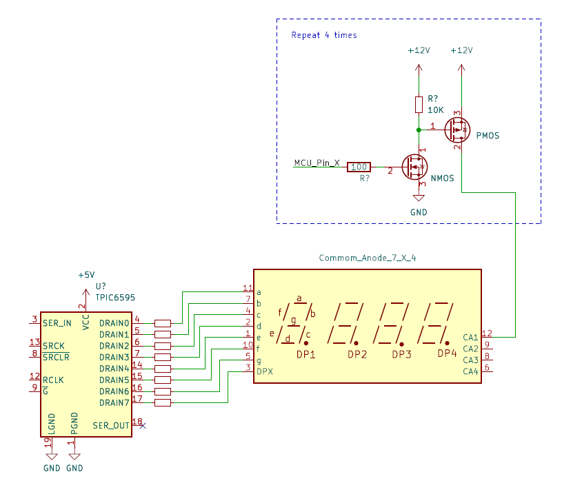

You could also do something like this. The TPIC6B595 is very tolerant (low side only) :

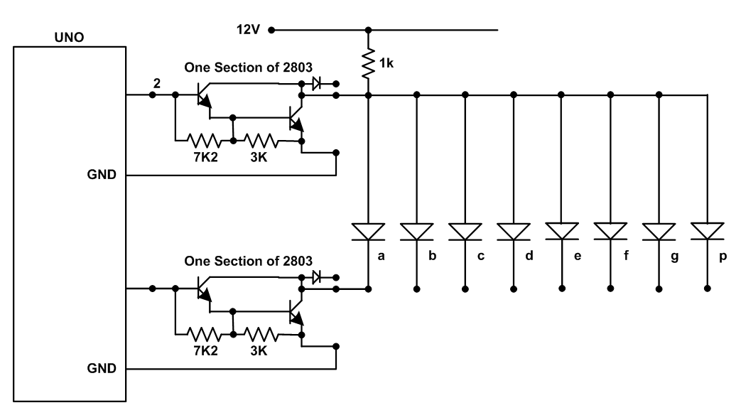

You may follow the scheme of Fig-1 to drive high power CA 7-segmnet multiplex display unit using ULN2803 buffers. Because of two inverters, the topology is compatible with SevSeg.h Library.
Figure-1:

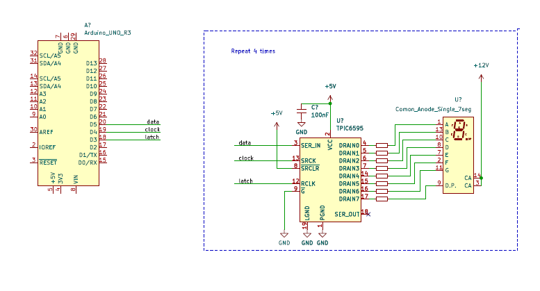

With four separate LEDs of that size, it might be easier to just use four TPIC6B565s and not multiplex the display.
Thanks but SevSeg.h consume may IO Pins.I already tried with SevSeg.h working smoothly issue is IO Pins.ShitDisplay uses only 3 IO Pins
Yes. You will definitely get help here. Decide the complete solution first. Since the displays are individual, a non-multiplexing solution with 4 X TPIC6B595 chips (as already suggested) will give brighter results and easier to code. 4 shift registers in a chain consume a total of 3 Arduino pins.

Thank You for kind support,its university project to display 4 Digit on CA display.Good idea to go with non-multiplexing solution with 4 X TPIC6B595 chips.

If you want to go with a 4 x TPIC6B595 solution, it could look like this. The shift registers are daisy chained.
EDIT
Removed unnecessary high side components as pointed out by @david_2018
