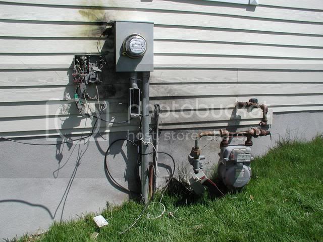

Give a thought to the communication between containers. Nearby lightning strikes will cause big voltages container-to-container. When your equipment is blown off the wall, make sure it doesn't set fire to the product.
The only sure way of avoiding this is fiber optic cables between the buildings (containers.) But wired connections are acceptable if you understand the risk.

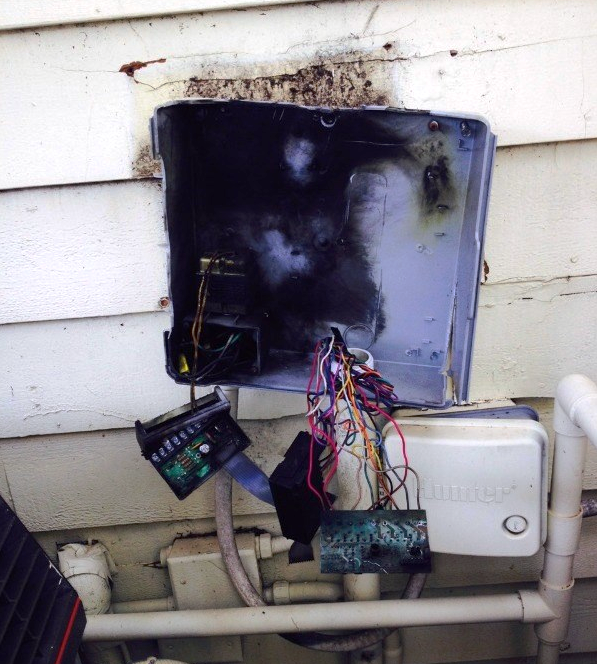

About the lightning. Why exactly is this a concern? Sure I could expect some weird data from the sensors at the moment a lightning strike hits but why would things start "blowing off the walls"?
When you get millions of Volts driving thousands of Amperes for extremely short periods of time, some pretty interesting things can happen!
What would be the solution to something like this? Ground the warehouse building and every container?
There is an entire industry built around lightning protection, so you should have no trouble getting information from the web.
That last photo even looks a little like an Arduino.
Now you know why your cable TV connection always has a box like this on the outside of your house. There will be a ground stake associated with this box to ensure the fire starts in the box and minimal energy is sent indoors.
One interesting design I saw once on a weather station was each incoming wire went to a PCB trace constructed as a spark gap. Any over-voltage would jump the gap and basically stop there. The idea is to protect the perimeter: let big zaps jump to a ground outside the container.
There is also a cost-benefit analysis: if thunderstorms are rare in your area or the installation only has a planned lifetime of 2 years then you would not spend a lot of time or money on this protection.
