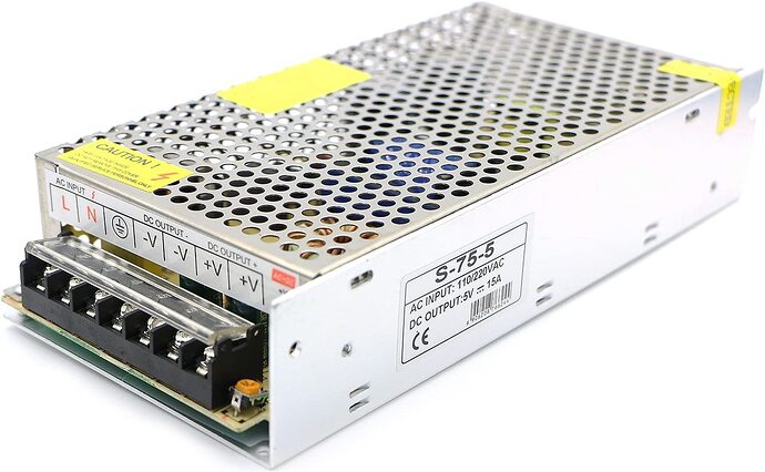

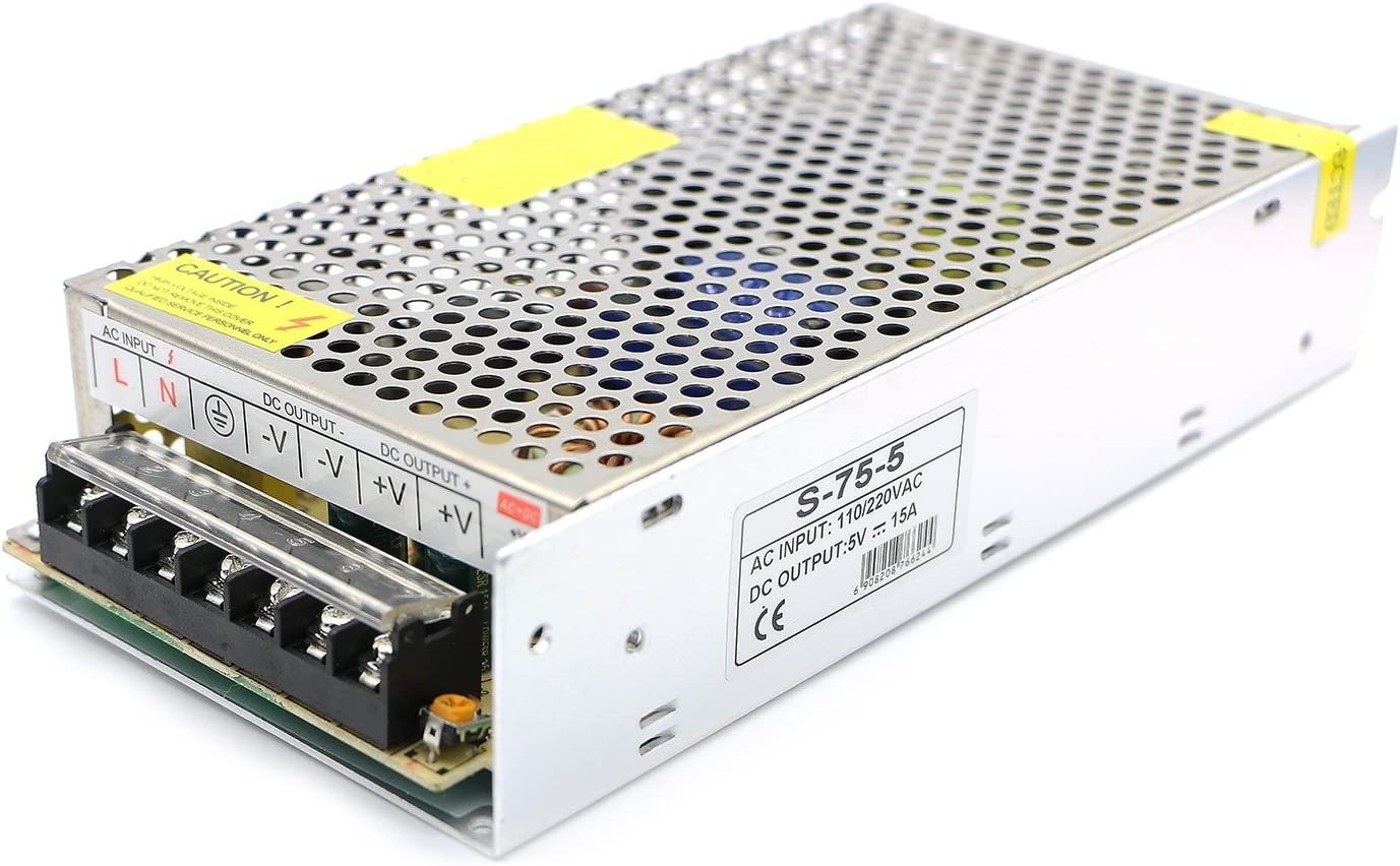

Ok so 60mA x 400 LEDs = 24 amps needed.
I want them at about 60% brightness, so 15 amps will do. This one is my guy right:
Thanks for your help Grumpy_Mike it is much appreciated.
I would not balance on the edge. Leave headroom, even if you are 100% sure you only drive them at 60%. So I would not get anything less then 20A if you want to go up to 60% brightness. Ad be 100% sure you don't accidentally write all white because that can damage the supply. Aka, add a fuse :slight_smile:

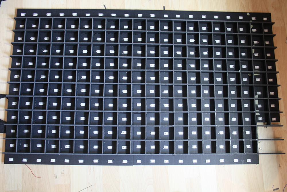

Here is how far i am in the project. If I made mistakes let me know, this took me a long time to put together, i have 2 months left for this project before I have to present it to a jury. I am an art student not electronics, I am trying to put this LED panel together for a performance/presentation. I guess you learn for your mistakes, so if I have time to redo it all within 2 months, let me know.
This is the front of the panel which took me a lot of time to glue:
And this is the back; which took me a lot of time to solder:
As you can see I am using really thin wires, 0.5mm.
As for the power output, for now I just have the 3 wires 5V, Gnd and Data connected to the arduino with 0.5mm wire, and my arduino is hooked up to my macbook pro via usb. I haven't tried lighting up all the LEDs at the same time yet, but I have already gone up to 160, and noticed the LEDs light starts to be shaky and unstable.

As to the wires they look fine to me. Remember these things are normally sold in strips and those wires will carry a lot more current than the PCB foil in a strip. What I would do however is to connect all the ends of the strips together, that is both the 5V and the ground. Do this on both sides of the rows and that way you will minimise any voltage drop, which is what generates heat and is the factor limiting the current capability of a wire. I don't think the comparison with domestic wiring is relevant here because 10A at mains voltage is one thing but it is not 10A at 5V.

However the photos are too small to see if you have decoupling capacitors on those LEDs.

PS The photo's are not that tiny but the forum likes to make them tiny inline... :confused:

  • Buy a 5V 20A power source, I really don't need full brightness, and if the LEDs ask for the 4 remaining amps when on full white, is it that of a big deal? Here is the power source I'm thinking of buying, is this ok? https://www.amazon.com/dp/B01JA3T8MI/ref=twister_B01JA3T7W4?th=1

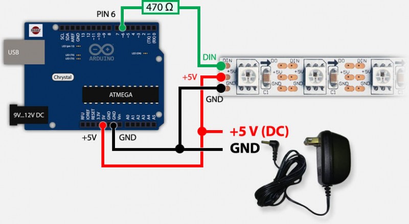

  • Add a resistor in series before the first strip on the data line.
Here is a picture of the setup I have to achieve, tell me if i'm mistaken:
Thanks a lot for your help, am I forgetting anything based on what you told me?
