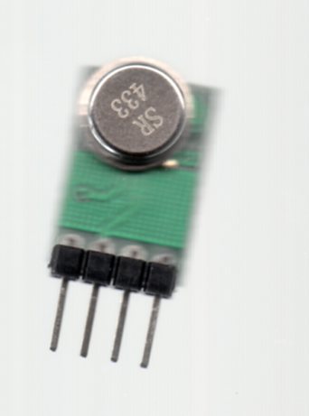

Right, got the receiver working. Thanks for the help folks.
Now to figure out the transmitter. I can't believe it cam with no documentation. All these devices are different.
How can i tell what pins are what. Will photo be useful?

Look on both sides of the board near the pins and hopefully it will have something. If not then send pictures of both sides of the transmitter. The example image I posted has 3x TX module pins that are DATA, VCC & GND as you look in the photo but yours may be different so best to be sure first.
I can't find it.
The pins are most of the times : Ground, Data, Vcc, Antenna.
If you look at the board with a magnifier, perhaps you can see which pin is ground and which is the antenna.
Its difficult to tell what is what. Even with a magnifyng glass... the back is really cluttered.
FTL
Do you have a flat bed scanner, perhaps that can make a good scan/photo.
Put your camera on manual focus, and back away from the paper it's on. The background paper in the foil side shot is in focus, but with the limited depth of field, the foil side is out of focus. Manually focus that camera if you can, else take multiple shots of both sides, and pick those two that are sharp. Keep it smaller in size, we can blow up a clear shot on this end.
Looks like they forgot to silkscreen the board ![]()
The image of the back (with components on) could be a bit clearer.
Looking at the front (the side with the big metal can) the second pin (from the left) is most likely GND but without a clear picture of the back cannot figure the other pins out.
Wait for other peoples opinions and hopefully grab a better image of the back but my guess is ANT, GND, DATA & VCC or ANT, GND, VCC & DATA

Two flatbed scans. Hope this helps.
FTL
This is still a guess as it's not certain where all the traces go but looking from the back (component side NOT can side) I think it's VCC, DATA, GND & ANT
Thanks alot for the help everyone. Esp Riva, I'll have a go at you suggestion, if it doesn't work i guess a new one WITH the silkscreen is whats needed.
