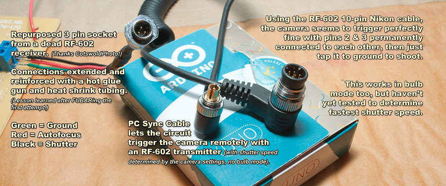

On the 3-pin socket from the RF-602 receiver, one pin is for AF, one is for the shutter release, and one is for ground. You need to connect gnd+AF before you can trip the shutter, but with the body set in manual focus mode, it doesn't do anything (except satisfy the requirement of being connected when you connect gnd+shutter). The AF + Shutter pins can actually be connected together so you trip both simultaneously. So, it only uses one pin + gnd on the Arduino. The code just sends it high, then 50ms later sets it low (I'm using millis() to check the time, so that my intervals are accurate and I don't have it locked up using delay()s). You need the 50ms delay to make sure that the LCD turns off and the camera actually takes the shot.
Really, I probably should be using 2 pins and controlling the AF and Shutter pins separately (then I don't need the 50ms delay before setting the pin LOW and the timings would be even more accurate), but until I know for sure I can afford to spare that extra pin, this method works. Btw, for those who shoot Nikon and are curious, regardless of whether I used 1 or 2 pins, the fastest shutter speed I could get the camera to shoot on bulb mode using the 10-pin socket is 1/6th of a second (even if it was only connected for an instant).
