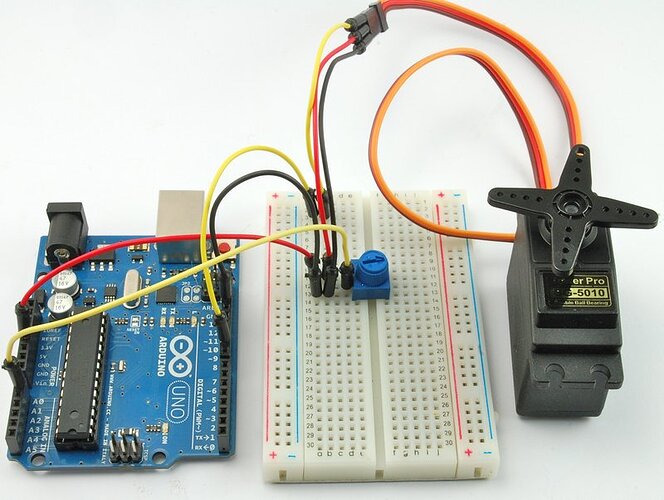

BillHo:
Servo - Arduino Reference
http://arduino.cc/en/Tutorial/Sweep
Overview | Arduino Lesson 14. Servo Motors | Adafruit Learning System
