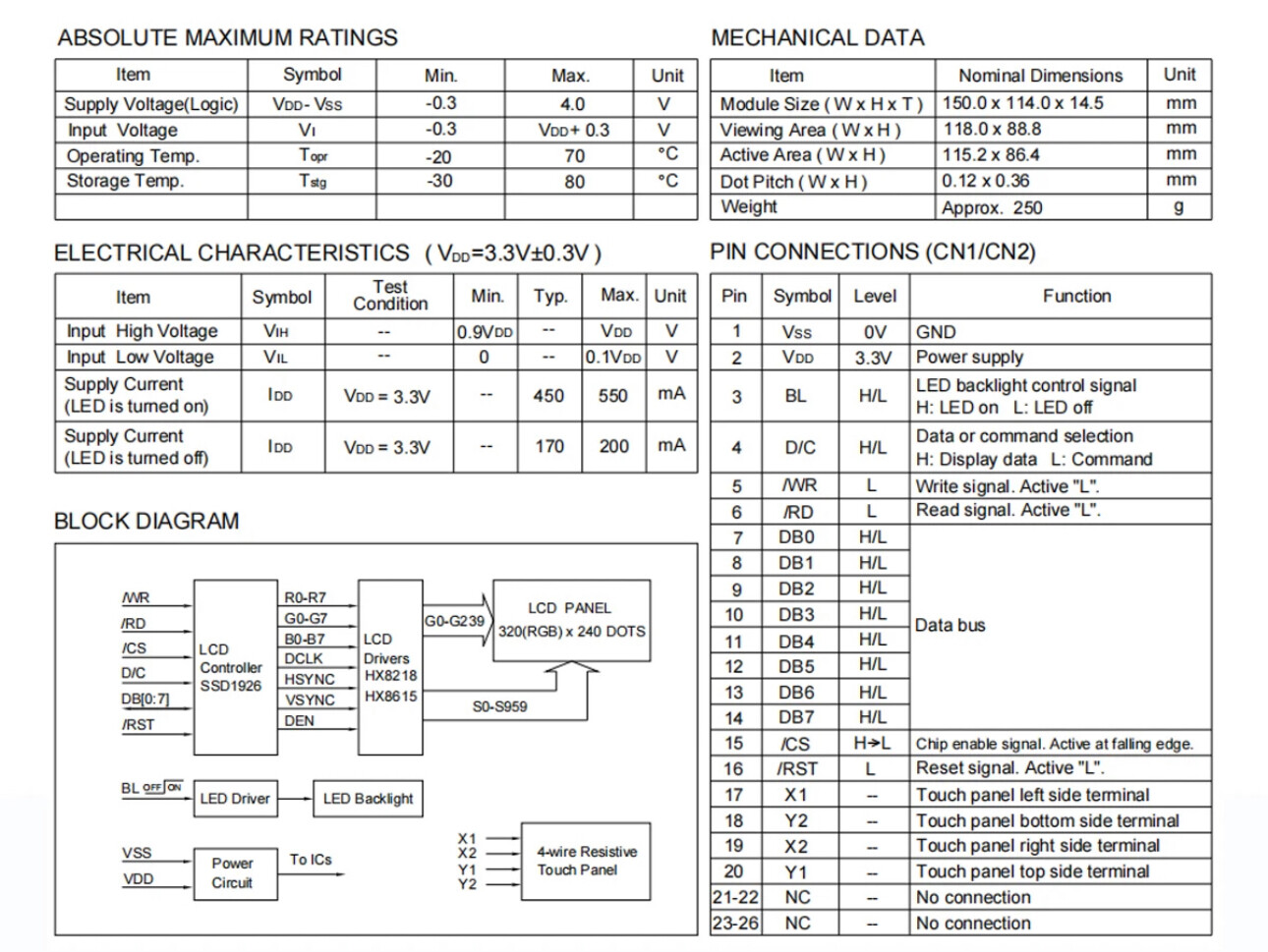

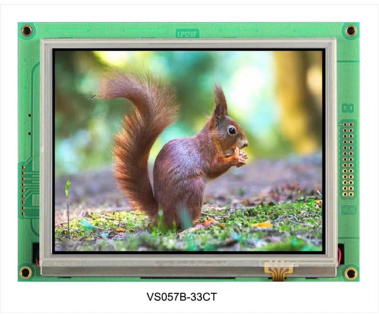

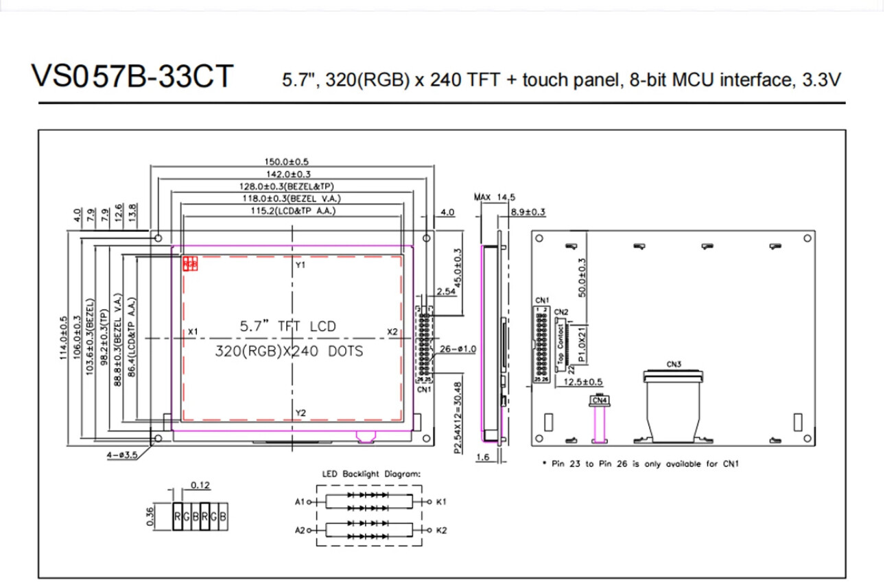

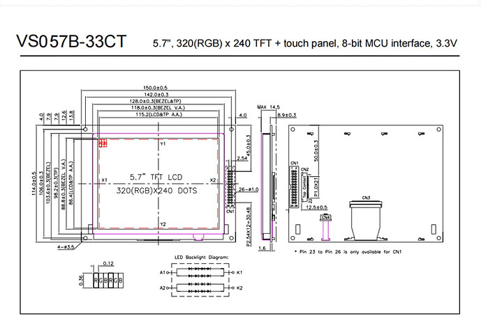

I found this VS057B-33CT 5.7", 320(RGB) x 240 TFT + touch panel, 8-bit MCU interface, 3.3V.
It has an SSD1926 microchip and an 8-bit MCU interface.
More information about the pin assignment and data in the attached images.
Now my problem!
I haven't found an SSD1926 library to work with the SSD1926 chip.
Does anyone have a solution or idea to run this display via the Arduino or maybe install a VGA or HDMI interface?
Note: The touch of the display can be ignored, it is not needed, unless it is not too complicated to get it working as well.
